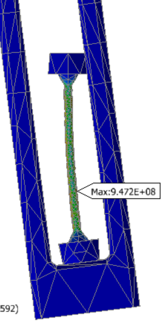

hello Henrik Sönnerlind,
Thank you very much for your response I Have a question.
For the system I don't want any sliding i just want it to be able to move in all direction (x y and z) but not able to rotated in the x y and z( the result im looking for is in this image) for the Symmetry condition does putting a free displacement work?
