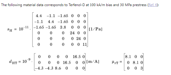

There wasn't any solver sequence, probably due to the missing piezomagnetic domain and the resulting error. COMSOL stopped before building the solver sequence.
Material data for magnetostriction is a difficult point. You can find data for the material used in the library example (a giant magnetostrictor like Terfenol, used for tranducers), but that is not valid for Iron. Iron and polycrystalline ferrous materials have a more complex magnetostrictive function. Also the current nonlinear magnetostrictive approach in COMSOL is not really suitable for materials like Iron, even if you had a magnetostrictive function. You may get a result but it is probably not correct.
I developed a method for the linear case with DC bias and a small AC perturbation, but this is not suitable for a transformer.

Could i use another material for the core then to get it to work?
>There wasn't any solver sequence, probably due to the missing piezomagnetic domain and the resulting error. COMSOL stopped before building the solver sequence. > >Material data for magnetostriction is a difficult point. You can find data for the material used in the library example (a giant magnetostrictor like Terfenol, used for tranducers), but that is not valid for Iron. Iron and polycrystalline ferrous materials have a more complex magnetostrictive function. >Also the current nonlinear magnetostrictive approach in COMSOL is not really suitable for materials like Iron, even if you had a magnetostrictive function. You may get a result but it is probably not correct. > >I developed a method for the linear case with DC bias and a small AC perturbation, but this is not suitable for a transformer. Could i use another material for the core then to get it to work?
Posted: 2 years ago 14 mai 2024, 10:20 UTC−4
Transformer cores are made from Iron, so I am afraid you can't.

Read thru it but still is it even possible to find desired magnetoelastic properties for Silicon Steel GO M-6 Rolling on internet?
Also could i ask you quick do i need some constraints in the solid? Or can i just leave it free
>Here is some good reading about magnetostriction. It is mostly about magnetostrictive transducers, not about transformers. However, it shows the magnetostrictive function of a typical low carbon steel (page 25) and how to derive a coupling matrix from that. It is good for general understanding, but will be a long way to model magnetostriction in a transformer. > >Hirao, M., Hirotsugu, O., Electromagnetic Acoustic Transducers, Springer Series in Measurement and Science Technology, ISBN 978-4-431-56034-0. Read thru it but still is it even possible to find desired magnetoelastic properties for Silicon Steel GO M-6 Rolling on internet? Also could i ask you quick do i need some constraints in the solid? Or can i just leave it free
Posted: 2 years ago 15 mai 2024, 03:21 UTC−4
In a time dependent study the solid can be free, in a stationary study the rigid body DOFs must be constrained.
I was doing extended research regarding magnetostrictive properties in the internet, but didn't find much relevant. You may consider to inquire with manufacturers. Of course it is possible to measure magnetostrictive properties of specific materials. Then you still need a nonlinear method that can handle the non-monotonous behavior of Iron based materials.
