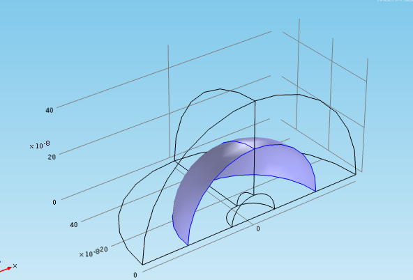

Can you provide some assistance as on how to define those equations? The first part of both equations are constants, so no problem there. I know how to define an integral in volume and in surface. Now come the questions:
- How do I extract the real/imaginary part of a function?
- Do you use emw.Ex, emw.Ey, emw.Ez and emw.Mx, emw.My, emw.Mz for E and H?
- To define D do you use emw.Px, emw.Py, emw.Pz?
- How do you define sigma(w)? I assumed it was used sigma=0 for the gold.
- How do you define Escat and Hscat? I assumed it was the Efar but there is no Hfar in COMSOL...
- What is the surface you use to integrate the Escat and Hscat? How far away from the sphere?
Sorry for the insistence in the topic and for any stupid questions but I am really trying hard to get a good result in this simulation.
Can you provide some assistance as on how to define those equations? The first part of both equations are constants, so no problem there. I know how to define an integral in volume and in surface. Now come the questions: - How do I extract the real/imaginary part of a function? - Do you use emw.Ex, emw.Ey, emw.Ez and emw.Mx, emw.My, emw.Mz for E and H? - To define D do you use emw.Px, emw.Py, emw.Pz? - How do you define sigma(w)? I assumed it was used sigma=0 for the gold. - How do you define Escat and Hscat? I assumed it was the Efar but there is no Hfar in COMSOL... - What is the surface you use to integrate the Escat and Hscat? How far away from the sphere? Sorry for the insistence in the topic and for any stupid questions but I am really trying hard to get a good result in this simulation.
Posted: 1 decade ago 17 janv. 2013, 17:37 UTC−5
- How do I extract the real/imaginary part of a function? [Type in the Help menu Mathematical functions]
- Do you use emw.Ex, emw.Ey, emw.Ez and emw.Mx, emw.My, emw.Mz for E and H? [Ey - is the full field, Eby - background field (incident), Erel - scattered field]
- To define D do you use emw.Px, emw.Py, emw.Pz? [emw.Dx = epsilon0_const*emw.Ey+emw.Py and is predifined already]
[what sigma?]
- How do you define Escat and Hscat? [Escat =Erel] I assumed it was the Efar but there is no Hfar in COMSOL...
- What is the surface you use to integrate the Escat and Hscat? How far away from the sphere? [up to you]

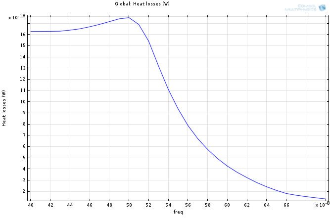

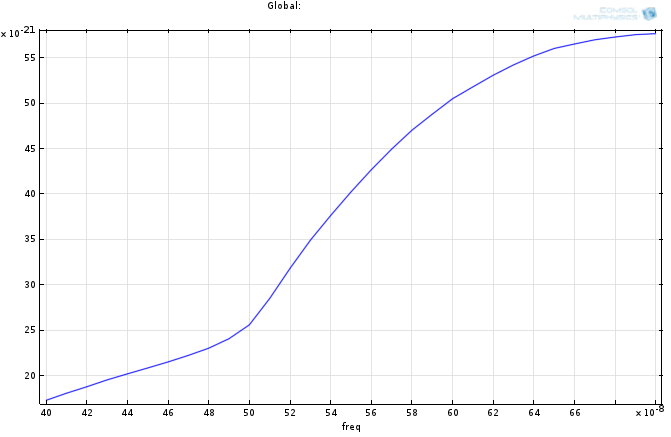

I have received some emails asking me if I was already able to plot the absorption and scattering cross sections of a gold sphere, so I know that this is a topic of general interest. As I said in the last post I was already able to obtain a resonance peak of the scattering cross section. Nevertheless the values don't correspond to the Mie values obtained for the COMSOL 3.5 version. I send an attachment with my results and the expressions I used.
I only defined in Parameters: E_inc as 1[V/m] and introduced the expressions for the cross sections in Definitions - Variables.
You can see the expected and obtained results, together with the expressions I used. Can you please comment on these for the general community? We would all appreciate.

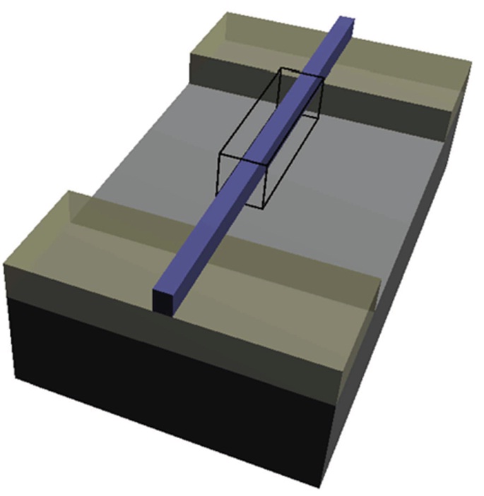

Dear Davletshin
thanksssssssss allot for your reply, i will attach to you my model, in simple words it is the interaction between the optical field (photons) and the acoustic field (phonons), so light (pump photons) will be scattered by the phonons (stoke), this is called brillouin scattering but how can i model this, i can not find it until now, i just get the optical mods but not the acoustic modes.
Best Regards
Dear Davletshin thanksssssssss allot for your reply, i will attach to you my model, in simple words it is the interaction between the optical field (photons) and the acoustic field (phonons), so light (pump photons) will be scattered by the phonons (stoke), this is called brillouin scattering but how can i model this, i can not find it until now, i just get the optical mods but not the acoustic modes. Best Regards

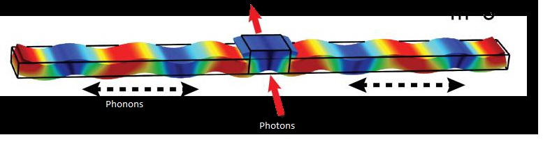

Dear Davletshin
i attached to you the wave guide pic just to see it and may it helps you to think in way with me to solve the problem.
best regards
