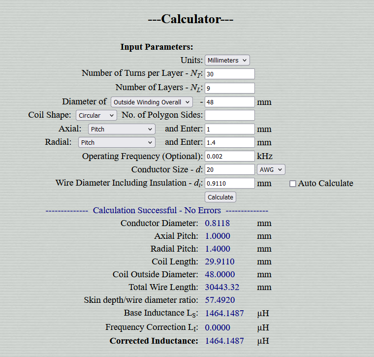

Posted: 1 year ago 30 mai 2024, 14:36 UTC−4
Ok, this is helpful. As you can see from the attached screenshot, I also find the theoretical coil inductance to be quite close to what COMSOL predicts.
Now I have matching theory and simulation, and I separatly have three matching experimental measurments. But the experimental measurments are all much higher than theory/simulation. I can think of several reasons (e.g., self capacitance) that would cause the experimental measurments to be too LOW, but too HIGH is weirder. I recongize that this may be more of a physics question than a COMSOL question, but if anyone has other ideas to think about, I'm all ears!

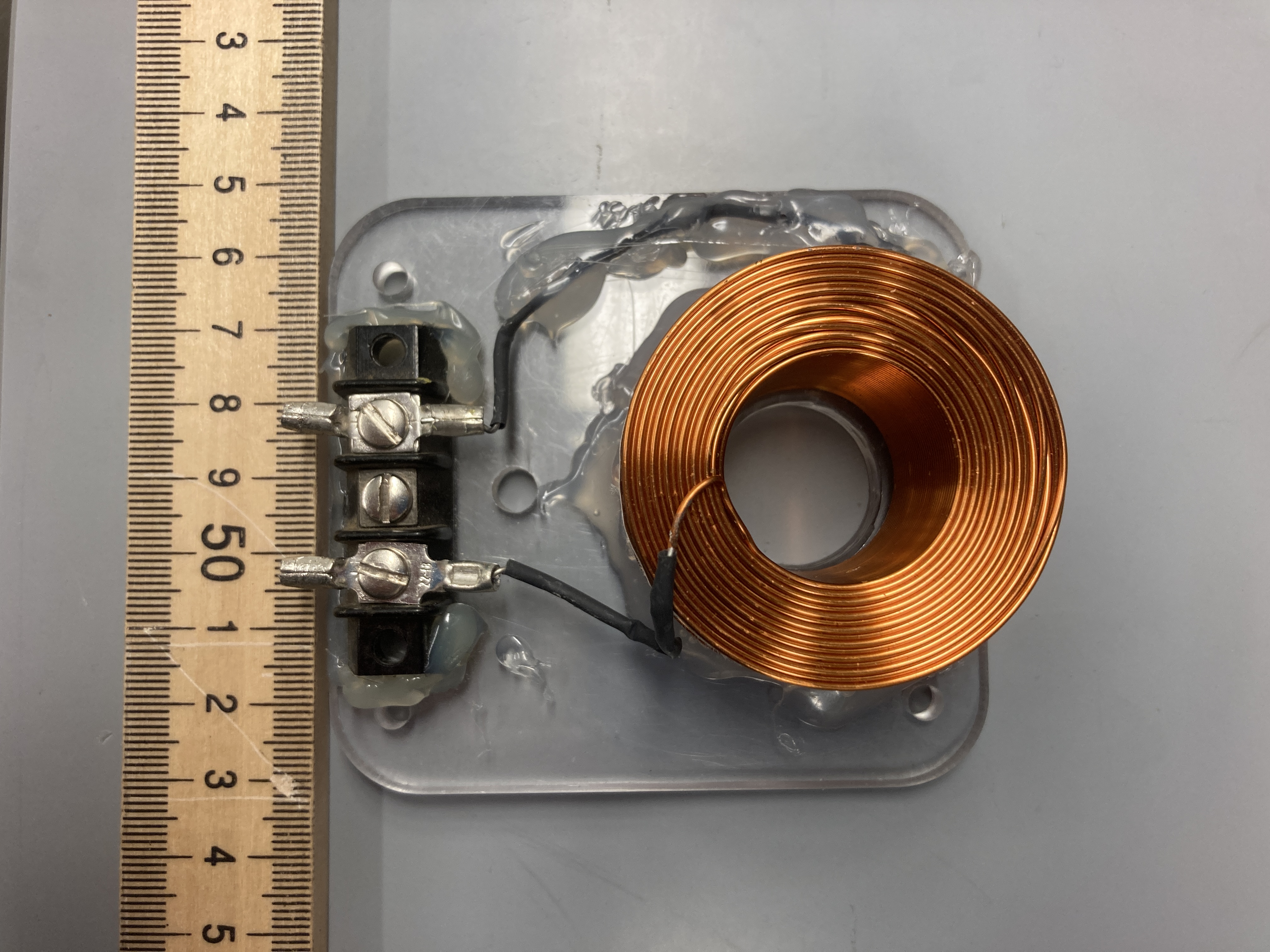

Care to show us a photo of your real-world coil? How do you know the number of turns? Did the manufacturer tell you how many, did they put that in their datasheet, or did you unwind the coil and count them yourself? Also, might there be any non-air but somewhat magnetic material in the core? Finally, are the turns wound around the symmetry axis (like a cylindrical spool of thread, as the model assumes, and which makes this a "short length solenoid" coil) or are they actually wound perpendicular to that, i.e., radially looping in/and out of the hole in the ring, and making this a toroidal coil?
Care to show us a photo of your real-world coil? How do you know the number of turns? Did the manufacturer tell you how many, did they put that in their datasheet, or did you unwind the coil and count them yourself? Also, might there be any non-air but somewhat magnetic material in the core? Finally, are the turns wound around the symmetry axis (like a cylindrical spool of thread, as the model assumes, and which makes this a "short length solenoid" coil) or are they actually wound *perpendicular* to that, i.e., radially looping in/and out of the hole in the ring, and making this a *toroidal* coil?

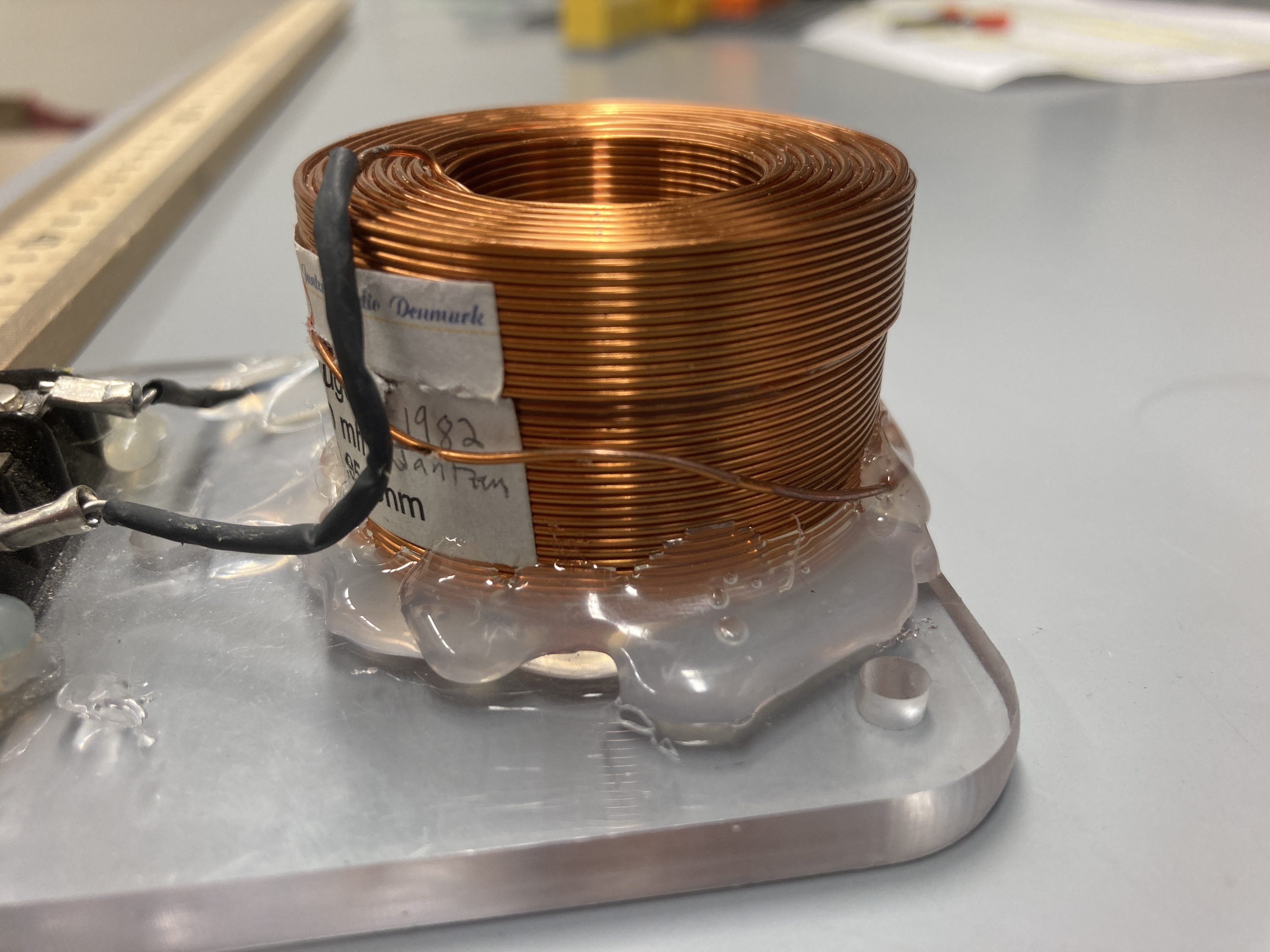

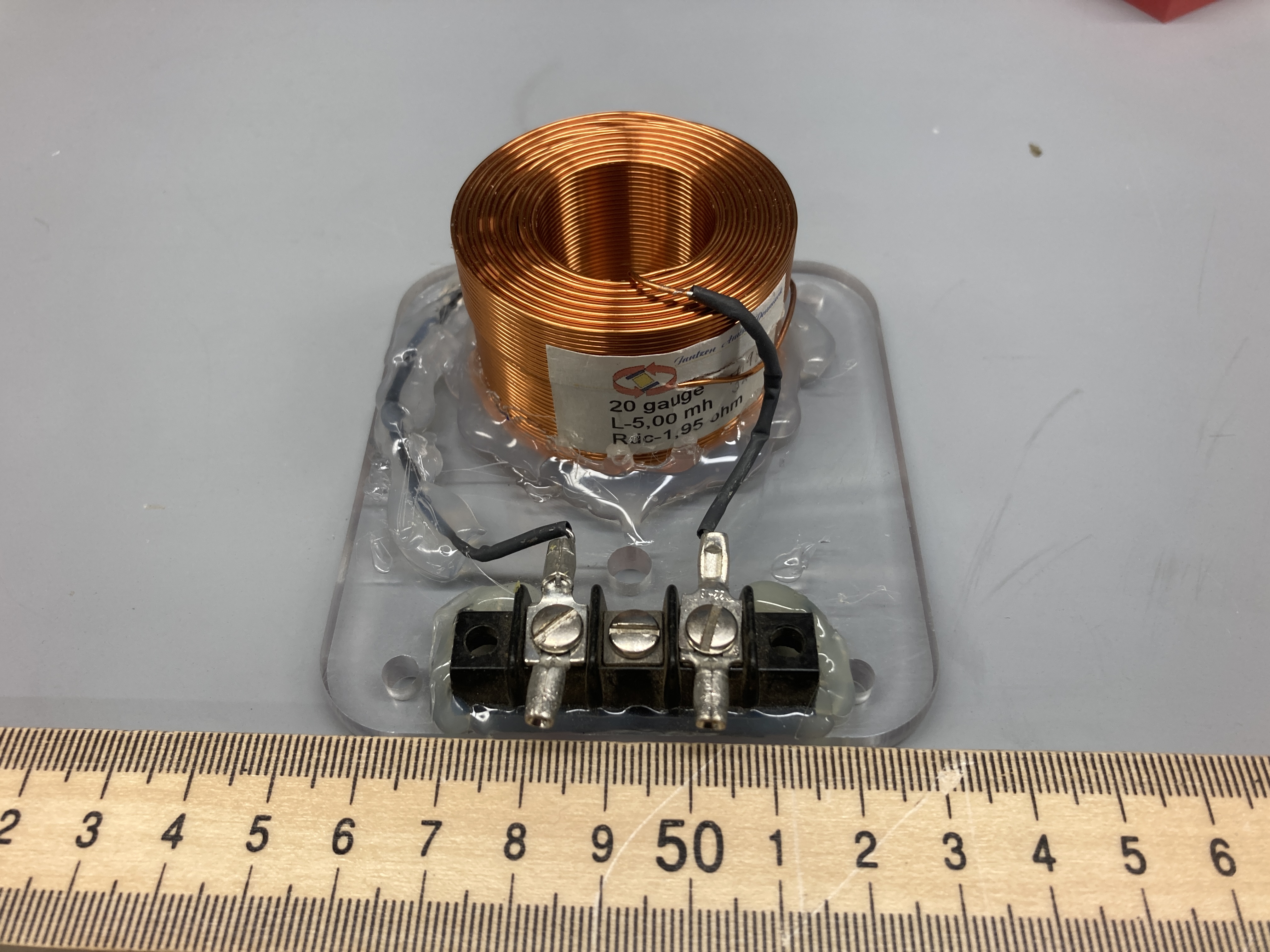

Posted: 1 year ago 30 mai 2024, 16:33 UTC−4
Good call. Here are some photos with a cm/mm scale.
Ok, I'll admit that I have NOT unwound the coil in order to count turns. I am just assuming it's uniformly packed throughout. There is definetly nothing in the core, but could there be some sort of anular magnetic material hiding within the coils? Yes, I suppose so... Since the calculator you linked very helpfully gives the total wire length, I'll check that against the resistance of my coil to see if things check out and report back.
Are the photos helpful, or should I take other angles?
Good call. Here are some photos with a cm/mm scale. Ok, I'll admit that I have NOT unwound the coil in order to count turns. I am just assuming it's uniformly packed throughout. There is definetly nothing in the core, but could there be some sort of anular magnetic material hiding within the coils? Yes, I suppose so... Since the calculator you linked very helpfully gives the total wire length, I'll check that against the resistance of my coil to see if things check out and report back. Are the photos helpful, or should I take other angles?

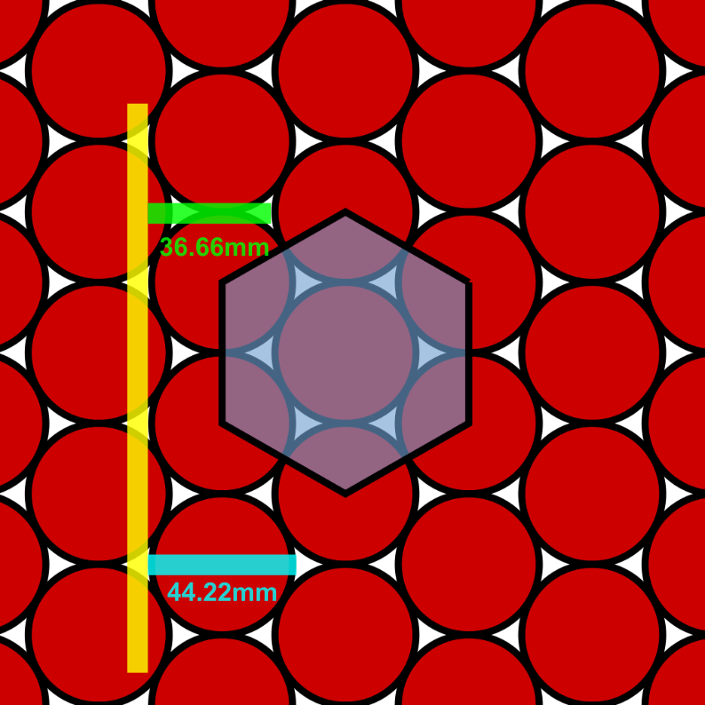

Putting that asside for now though and setting the coil back to the numeric type, I beleive I may have found the solution... and I must admit that this whole problem appears to be due to a mistake on my part rather than any technical problems.
It is very easy to count the number of turns in the axial direction for my coil. It also APPEARED to be easy to count the number of turns horizontally as well--I could only see 9 turns on the top layer and 8 on the bottom layer. However, digging into the coil a little bit, I realized that the wires are actually better approximated by "hexagonally packed" circles. Per my calculation (see attached image), each column of conductors should only take up about 83% of the circle's diameter. Thus, I now realize that the coil has about 16 layers! Feel free to make fun of me--I had really convinced myself I was right, but I was missing about half of the turns. If I plug 16x30 = 480 turns into COMSOL, it gives me an inductance value of 4.8 mH, which is very much in line with what I would expect. (5.0 mH). Updated simulation is attached.
With my updated geometric picture, I decided to calculate the length of copper wire by hand. I calculated the radius for each layer, found the circumfrance of a loop in that layer, and then multiplied by 30 loops axially. I added up all 16 results and determined the wire length to be about 54.7 m. Assuming 20 AWG wire has 10.15 Ohms/1000ft, I get a resistance of 1.8 Ohms. The actual resistance is 1.95 Ohms--not too bad.
I will say that I can't really get the electronbunker.ca simulation to match as well. I beleive this is because it does not appear to allow for hexagonal packing. It does not permit the radial pitch to be anything less than the total wire diameter.
Thank you both for your help!
