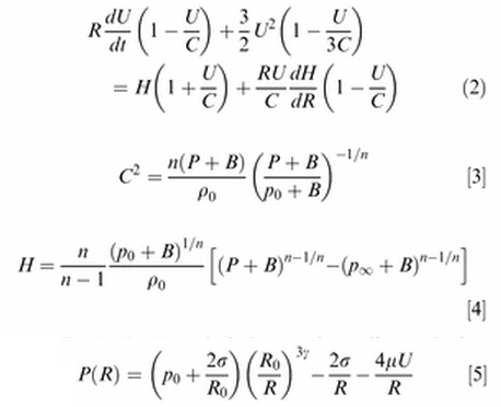

Hello, I am trying to model the radius, R(t), oscillation of a cavitation bubble in liquid (compressible) subjected to alternating pressure at ultrasonic frequency. I would like to model the radius oscillation using the Gilmore model equation as shown in the attached .jpeg file.
The link to the published paper is as follows: link.springer.com/content/pdf/10.1007%2Fs11661-012-1188-3
I have tried to model equation (2) through the ODE module and by specifying the derivative of H by d(H,R), and managed to get the model running. However, the result seems to be very different from the results for the change in the bubble radius, R(t), presented in the paper.
