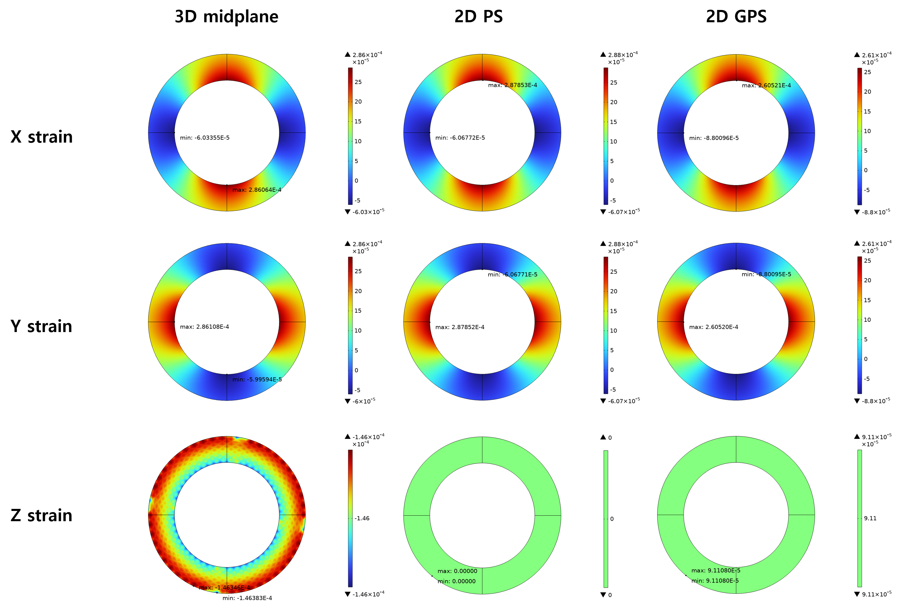

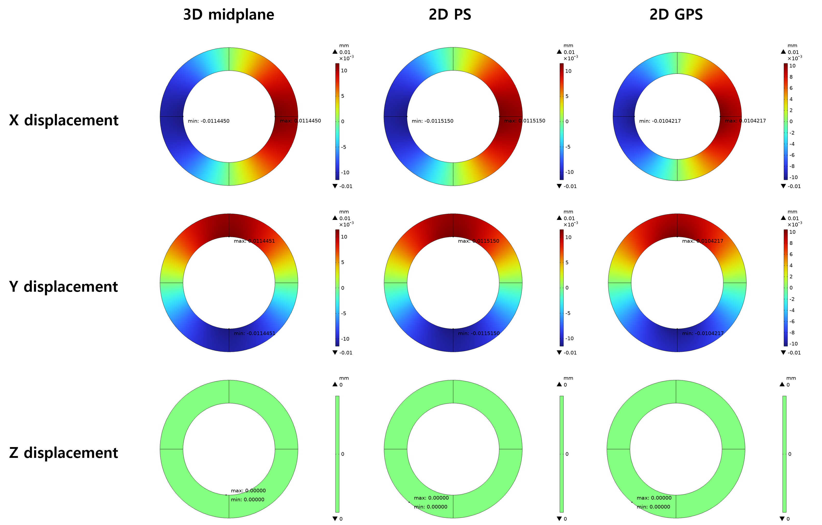

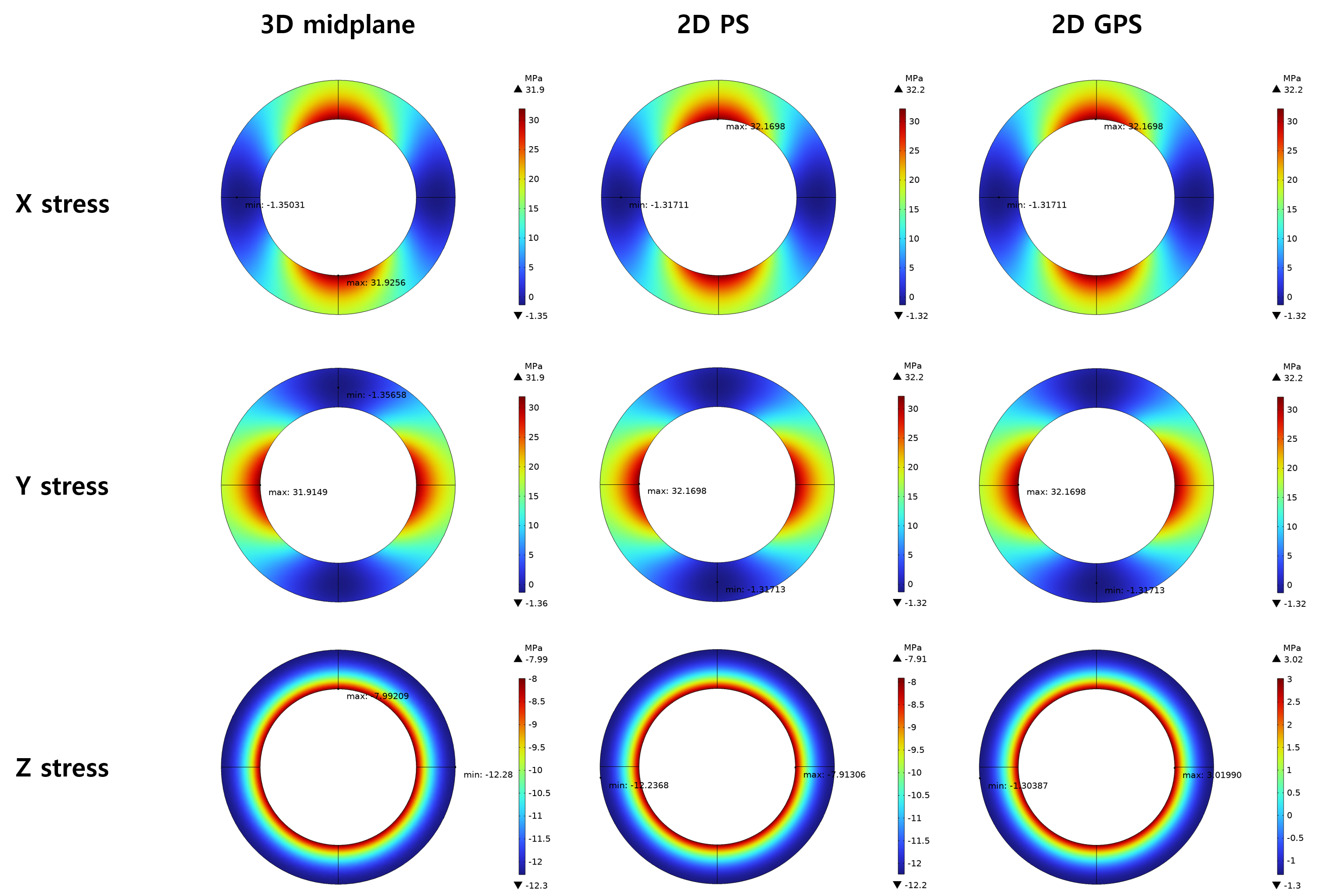

As an example, let us look at a simple solenoid case comparing the 3D midplane results with 2D plane_PS(PS+external strain) and 2D plane_GPS(GPS+external strain). All three models have the same loading condition which results from Lorentz force by applying 200 A/mm^2 in phi-direction. For 2D models, the force in z-direction is zero so this effect was accounted for by giving the resultant strain in z-direction (-0.0001464) obtained from the 3D model.
Thre results comparison for three models are shown in the figures in the image link-> https://postimg.cc/gallery/H851c4p 3D model and 2D_PS model shows consistent results with only difference in z-direction strain. It seems that the 2D_PS model solves the problem ignoring the external stress at first then recalculate the stress in z-direction with the given external strain. But then external strain value is not reflected in the final result (just displays 0 just as default value for typical PS condition). While 2D_GPS shows about 10% of difference in strain as well as in displacement, the stress in x and y-direction are consistent with other models. But then the strain and stress in z-direction shows entirely different results! This is where my mind is blowing.
