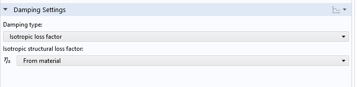

Thank you for your reply. I am operating in the frequency domain; actually, I am replicating a work from a paper where the author operates in both the frequency domain and eigenfrequency. Can the complex dielectric that you refer to also be applied to eigenfrequency? In the settings of Electrostatics > Charge Conservation 1, it is possible to set up Dielectric Loss for the Constitutive Relation D-E. This option asks for the real part and the imaginary part of the complex dielectric. Is this the setting where I can configure the complex dielectric permittivity you are referring to?
Could you inform me if I can use 'Damping' as a form of mechanical loss?
Once more, thank you for your help.

Yes, you can use damping as a mechanical loss mechanism. The dielectric loss should be a correct approach in electrostatics.
Alternatively you can set the complex permittivity in the material properties in the form eps1 + j * eps2.
eps1 and eps2 being the real and the imaginary part of the complex permittivity.
Cheers,
Edgar

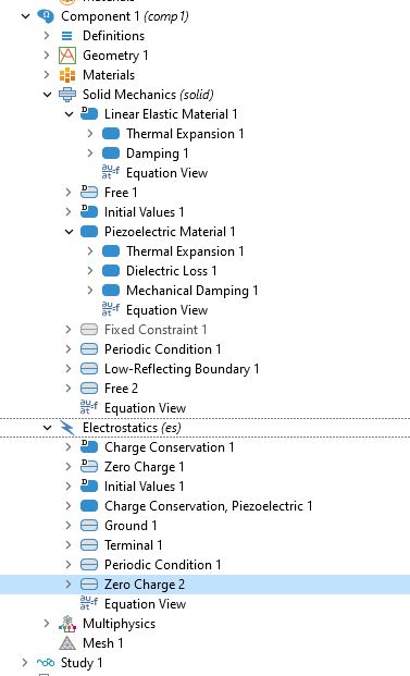

In fact, what happened was that I had incorrectly set up one of the properties of the piezoelectric film. Now it is working. I am still not achieving the same results as in the paper I am trying to replicate, but it is better than before. Thank you for your help. I suspect that I am doing something wrong with the physics of the model. Can you tell just by looking at the picture I sent in the first message if I am forgetting something?
Thank you for your assistance.

No, you need to post the model and describe in more detail what the discrepancies are between your results and the literature
