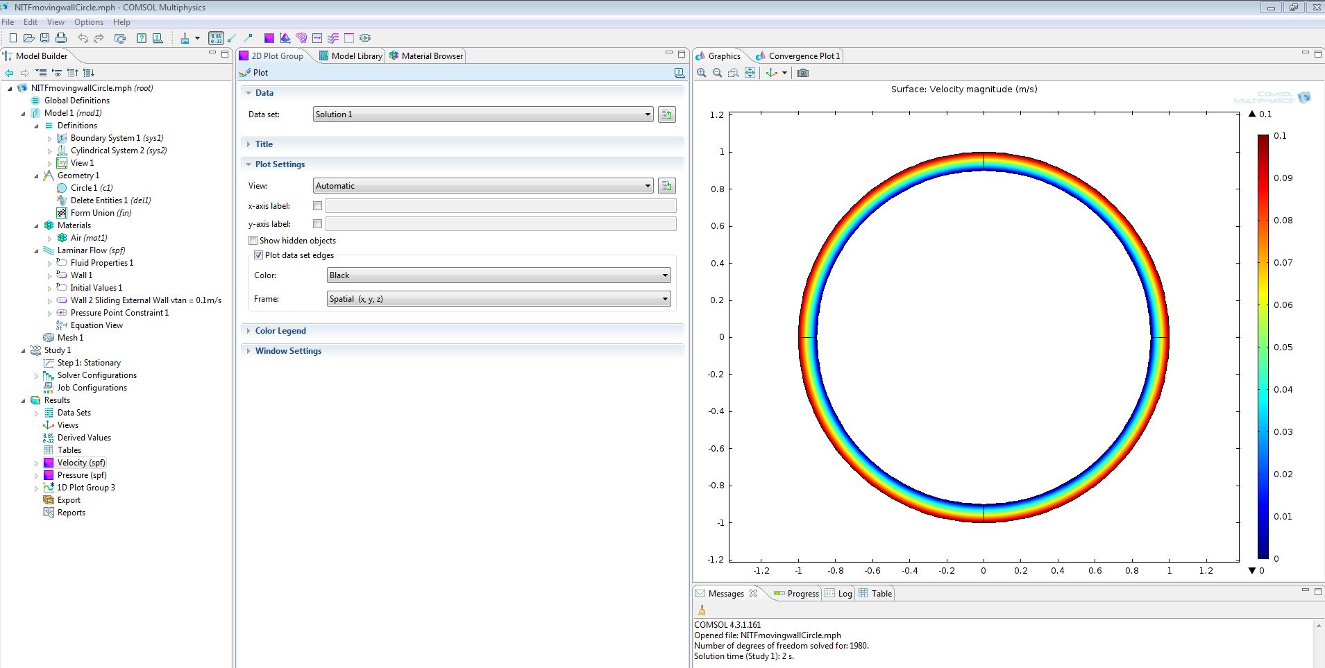

I would say, yes you can, with a sliding wall
my rectangle case is not converging to the default value, but the result is still OK, the concentric circle is OK
Files are 4.3a (if I manage to attach the files, ... now it works ;)
Hi I would say, yes you can, with a sliding wall my rectangle case is not converging to the default value, but the result is still OK, the concentric circle is OK Files are 4.3a (if I manage to attach the files, ... now it works ;) -- Good luck Ivar

Posted: 1 decade ago 18 janv. 2013, 16:04 UTC+1
here is a screen view, very simple set-up (oops have a Opera <-> Java update issue cannot upload from here anymore, checking with IE)
Hi here is a screen view, very simple set-up (oops have a Opera Java update issue cannot upload from here anymore, checking with IE) -- Good luck Ivar
