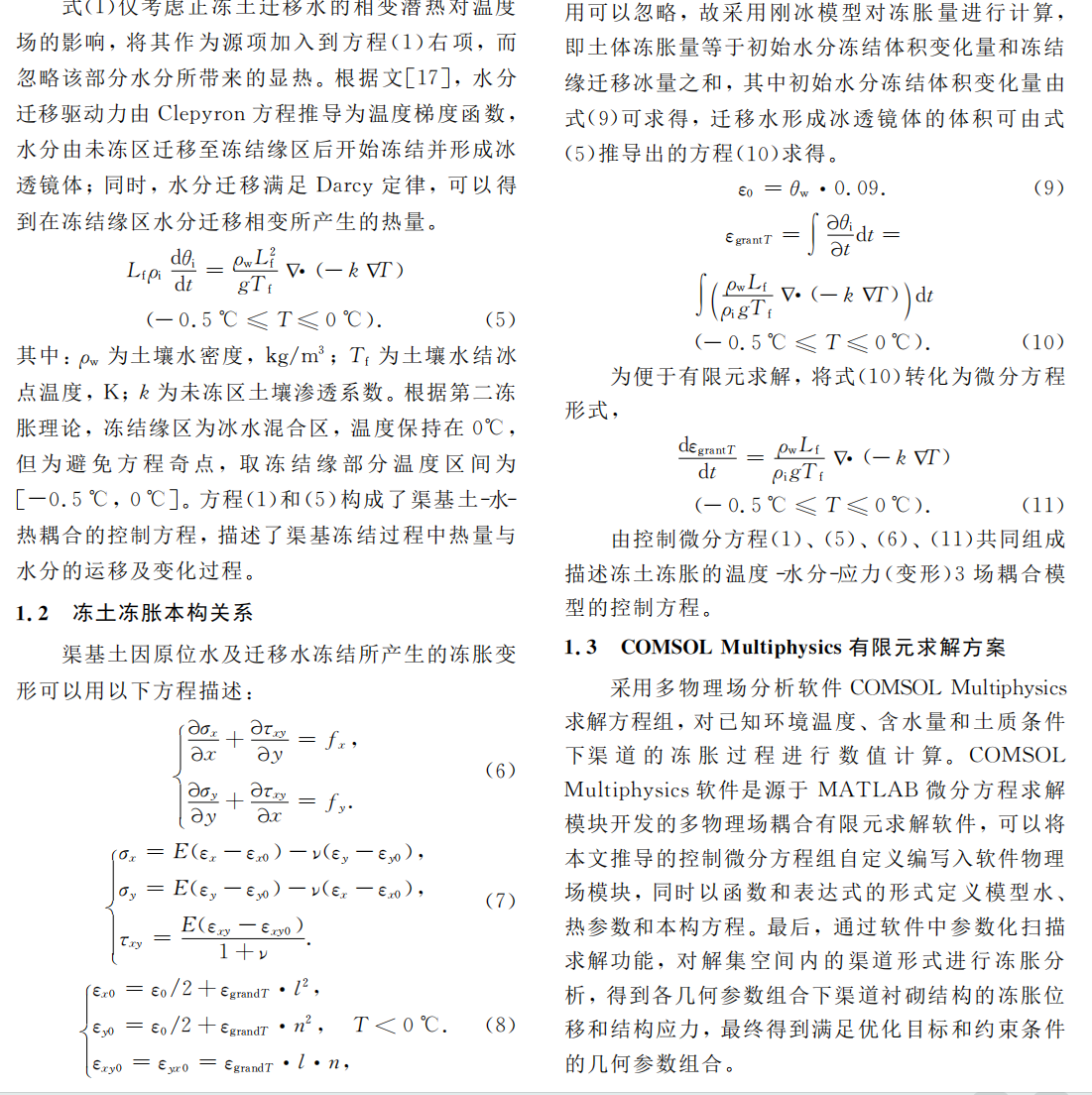

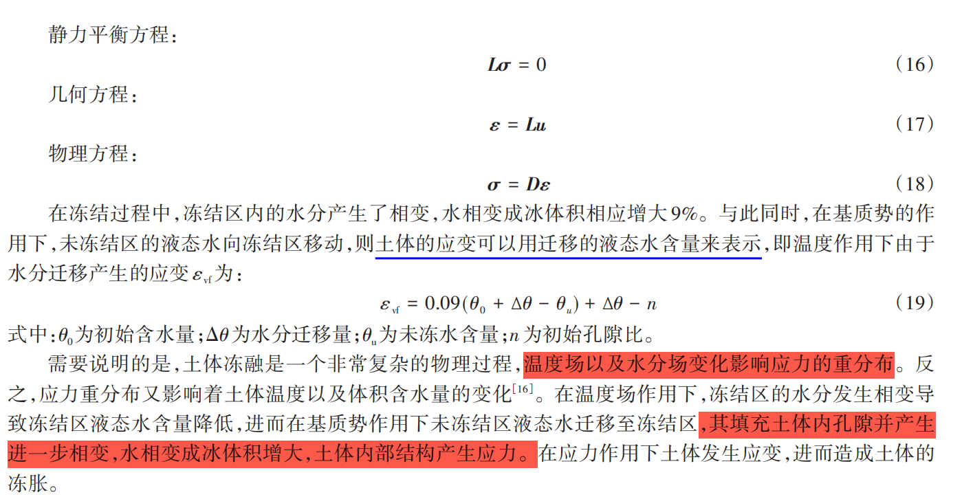

Hello, I would like to ask how the frost heave constitutive relation of frozen soil is reflected in solid mechanics in the three-field coupling model of water and heat? The following is the stress-strain relationship mentioned in the two papers, I have not figured out how to add it, according to my own ideas to calculate the frost heaving displacement is less than 1CM, obviously wrong, solve, thank you.
