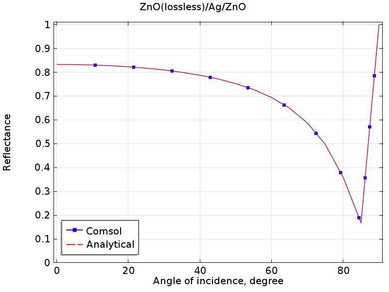

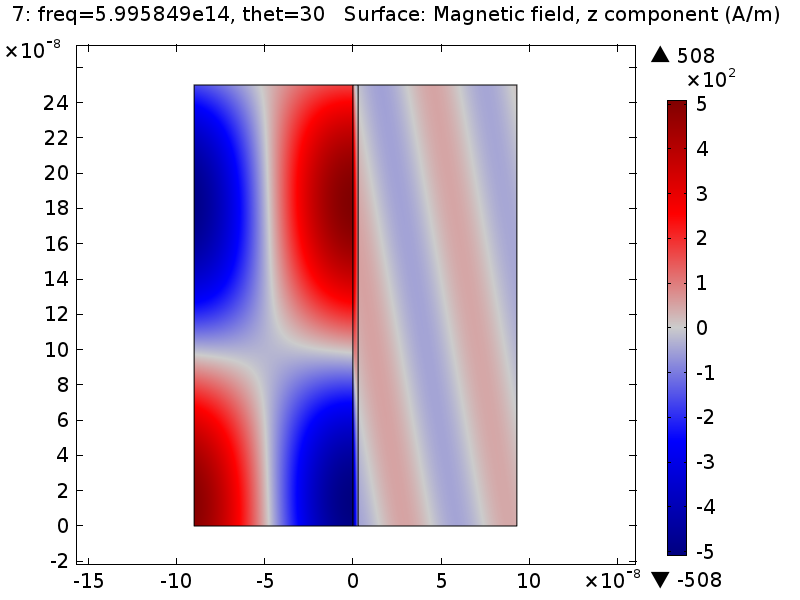

I don’t have 4.1, so I am attaching report of your model created with later version. Comparison with analytical solution for the case of TM polarization is also included.
I set the conductivity of the first ZnO layer to zero because it does not make much sense to specify evanescent wave at the input port. If you want to study wave attenuation in the first ZnO layer, then you might want to model structure with four layers: first layer is lossless dielectric (say, air) where you specify incident wave, second layer is ZnO with specified thickness, etc.
Sergei
Attached is model file. Please note that this is 4.3a.
