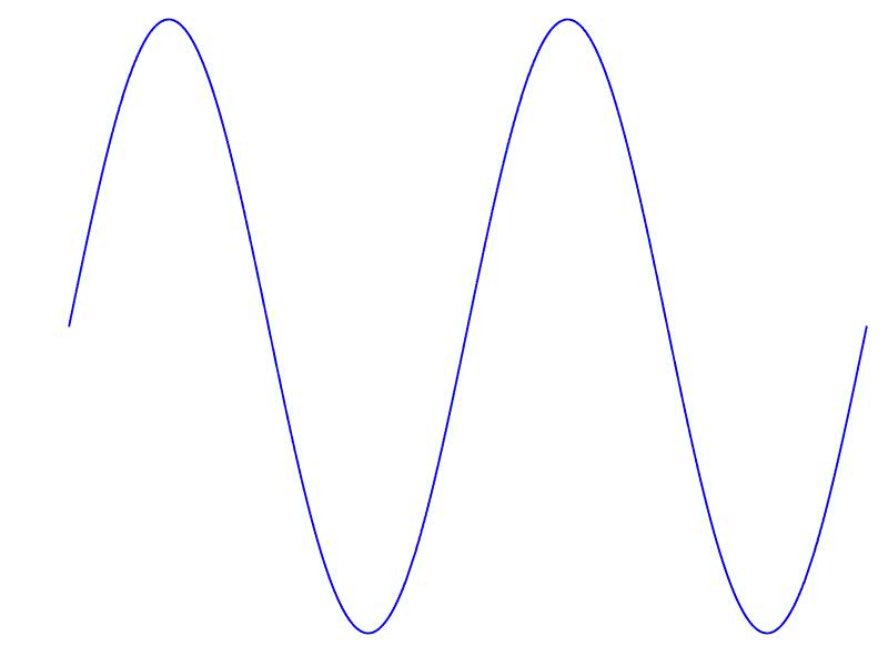

I defined a waveform funciton as wv1
( amplitude 5 (no unit), angular frequency 50*pi; phase 0 )
and I can draw it's waveform with amplitude 5( no unit, does that mean 5V).

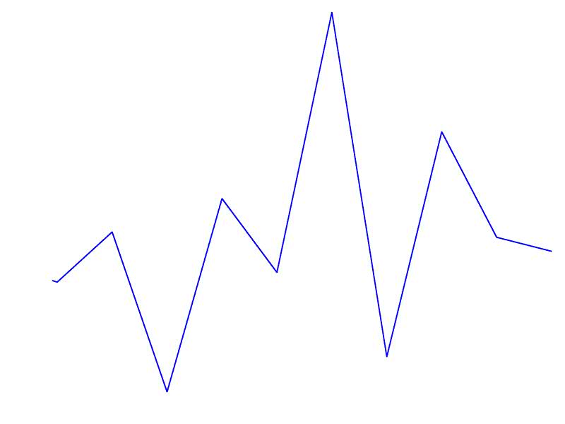

And I define a global parameter as Vdc = 5* sin( 50 *pi ) [V], I can plot it's waveform
in the Result section using 1-D global, and the result is a discrete sin waveform.
When I use wv1(t) or wv1(t[1/s]) as a parameter to replace the global parameter Vdc,
the Result is a non-uniform waveform , especially the amplitude is very small.
Please see the attachment pic.
Also, the runtime of COMSOL is much much longer when using wv1.
Thanks !
