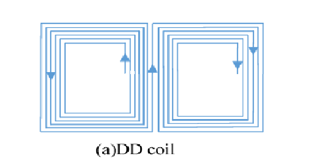

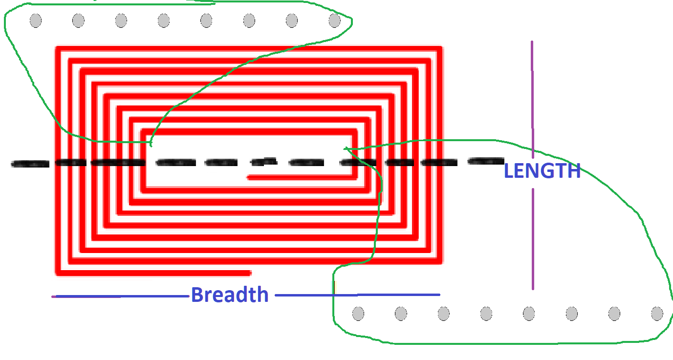

How to model rectangular structure in 2D having different depths?
In COMSOL, we can define the depth for the simulation only one time. I want for each conductor, different depths. How can I design it?
