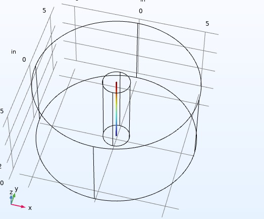

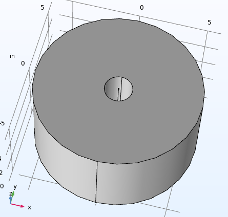

Hello, I was wondering what is the right way of using 1D extrusion/projection to a 3D surface. I understand projection decreases the number of dimensions.
What I am trying to do is to project temperature from a 1D pipe to a 3D surface, where x and y will be the pipe wall temperature as a function of z.
Since, the pipe is in non-isothermal conditions, I dont want to average my values. I tried linearizing it to 1D line on my surface, it didnt work.
