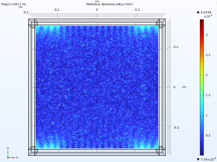

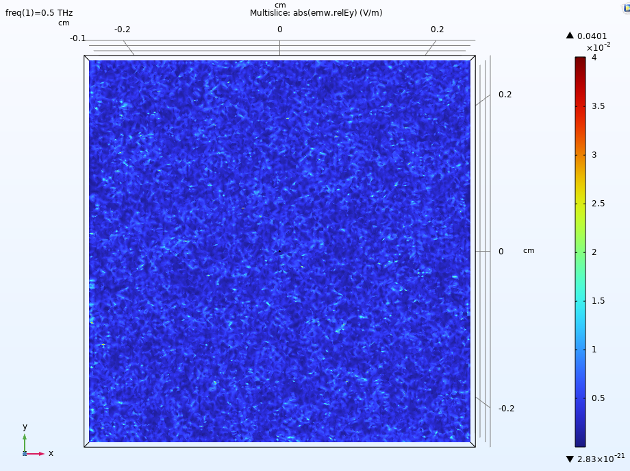

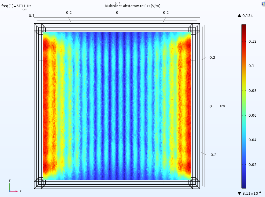

I was asking a physics question to relate it to computational. So for example, the model that you just helped me with, when i plot the abs(emw.relEz), i get 0.26 V/m amplitude while the abs(emw.relEx) gives 0.78 V/m. This makes the Ez component quite significant here. This is the reason for my question. can this be a simulation noise or something? If so, is there anything you recommend can help fix this?
The scattering boundary conditions on the sidewalls are not really correct for this configuration. If you replace them with PECs on the walls normal to the x axis, and PMCs on the walls normal to the y axis, then those will cleanly fit the example incident plane wave and you will see the Ez component nearly vanish. If you are interested in exploring a non-normal angle of incidence, you may have to introduce some other boundary condition, such as perfectly matched layers, or even appropriately periodic conditions, such as Floquet boundaries.
-------------------Scientific Applications & Research Associates (SARA) Inc.
So you mean the boundaries on the X-axis should be PEC and the boundaries on the Y-axis should be PMC.? Is this because the plane wave is x polarized or the PEC and PMC on the boundaries does not matter.
I have added two models , which one is the correct setup
Electric field lines terminate on PECs, while magnetic field lines terminate on PMCs. As I explained, use the "PECs on the walls normal to the x axis." When discussing a vector quantity, "normal to" means "perpendicular to." This corresponds to your Example2.mph, for incident polarization (E) parallel to the x axis (and thus the PEC surfaces must be perpendicular to E).

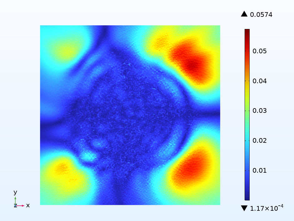

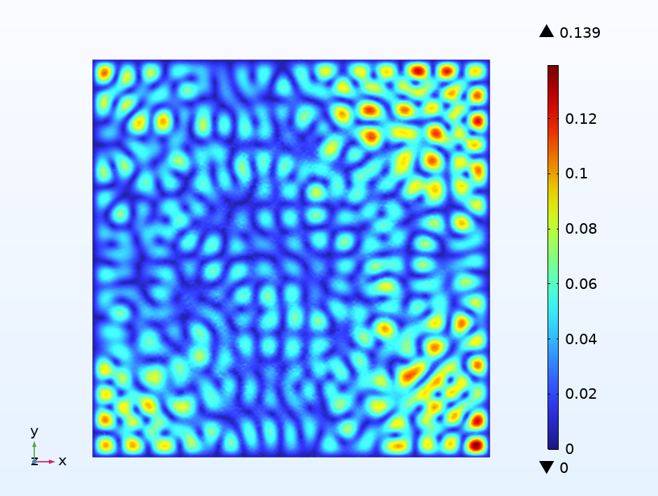

- Hello sir, I used your suggestion on my problem above. I investigated both PEC/PMC boundary conditions as well as PML. I realized that PEC/PMC gave me the results I expected but the PML results is questionable. I wonder if I did something wrong using the PML. My geometry will become complex in the future so I dont want to rely on PEC/PMC . Is there anything I should do? I have attached my files and results . I welcome your suggestions.Thank you.
It seems to me that your objective here is to simulate a representative subsection of a larger space, perhaps even an array (in effect, if not necessarily deliberate). Of course, if your incident wave is at normal incidence, you can use the PEC & PMC sidewalls previously discussed. But if you want to consider cases where the incident wave is not at normal incidence, then you may wish to consider a model using Floquet boundary conditions. There are a number of examples in the Comsol Application library. See, among others, https://www.comsol.com/model/modeling-of-pyramidal-absorbers-for-an-anechoic-chamber-12129 . That application shows how to use periodic floquet boundaries, and also provides one example of the use of a PML, relevant to this kind of work. Perhaps the RF absorber in that model is analogous to the cancer tissue in your model? If so, studying that model might really help you. Good luck.

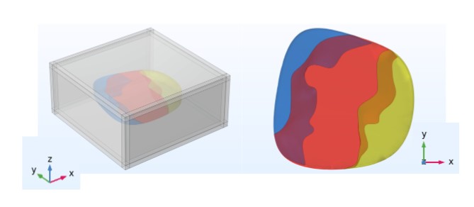

My wave is at normal incidence so the PMC/PEC walls was valid. However, my goal is to simulate a structure like seen in the attached file, called figure. Initially when I used SBC and PML, I was getting electric field components in the Z.which was what i did not understand since my plane wave z propagated. My initial guess was that, my structure might not be flat. This is why i decided to use a simple flat structure as I have shown in our previous exchange. I was getting Ez components which was solved when i used PEC/PMC walls. However, when I used PEC and PMC walls, on my real geometry (figure), the results gets worse. I even get Ey and same Ez component. The PML works better on my real structure than PEC/PMC. I am just trying to understand why I get Ez components regardless of what i use. And since my structure will get more complicated, I dont want to rely on PEC/PMC walls. Please refer to the attached files for confirmation. I couldnt get my .mph files to be less than 5MB, so if you need to review that, I can send it to you anyhow you prefer. Thanks.
I'm sorry, but I just don't have time right now to review this topic and your models further. I encourage other contributors to this site to offer their suggestions.
