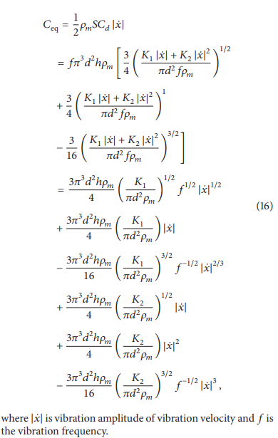

                                                    I think the best option is probably to add Spring-Damper features in the Plate interface, and enter the long expression as damping coefficient.
This will give you a nonlinear frequency domain problem. The solver can handle this, though. Just be careful not to have anything that is nonlinear in the displacement. That is not compatible with the assumptions about harmonic variation of the displacements.
Thus, it is OK to have a damping coefficient that depends on the amplitude abs(u), but not directly on the complex-valued u.

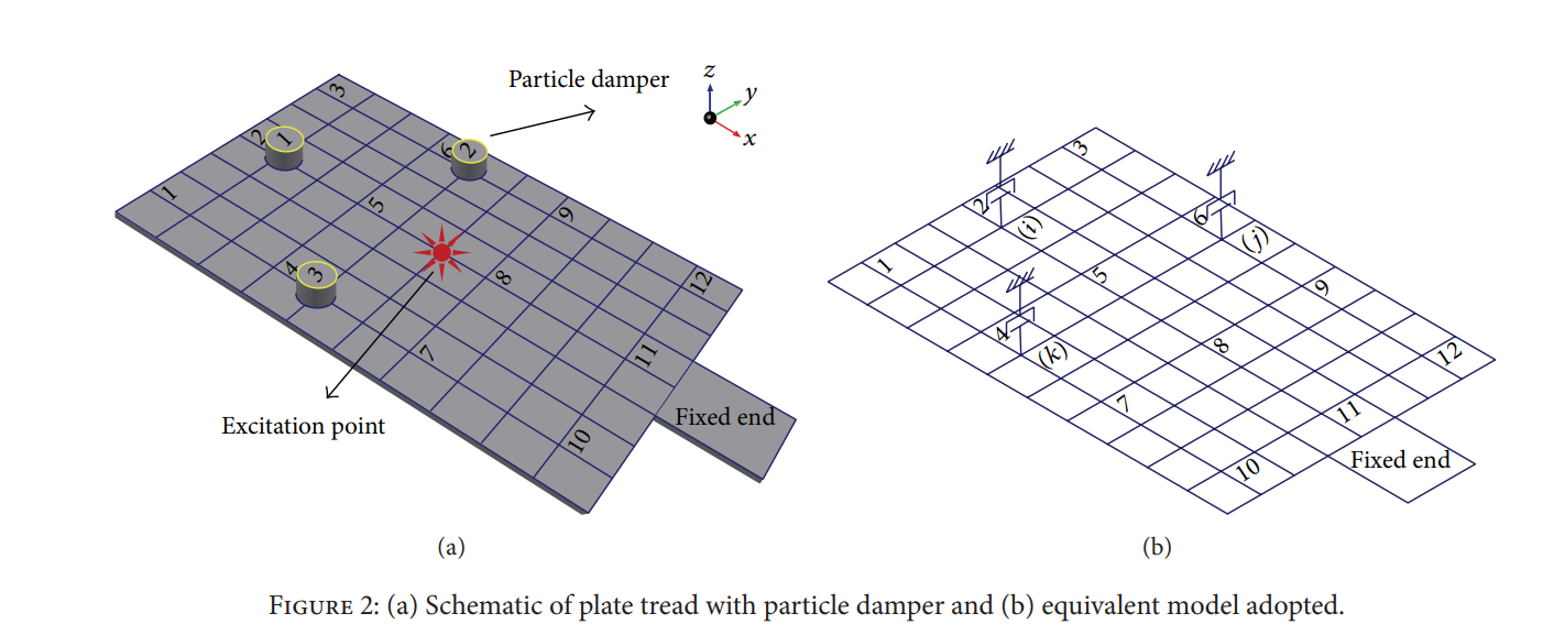

                                                    Dear Henrik,
since my model is mass-damper and not spring damper it could not work.
I attach model to have an idea where the lumped mechanical system is attached to one point of the structure using some default value for damping and mass coefficient.
My problem now are two:  when i m trying to study the problem, i got an hanging node exactly
where i  put the discrete damper. (I have tried to refine the mesh but it's still not working or using create vertex).
I add the coupling between the lumped and the mechanical structure but i do not know which are the source input and output of the  coupling since it' all the structure that is coupled and not point.
do you have any hint?
PS i attach also the article which i m trying to reproduce:
Vibration Response Prediction of Plate with Particle
Dampers Using Cosimulation Method

                                                    In the  sketch you attached to the first posting, it looks like 'grounded' dampers. If there is a mass at the end of the damper, one possibility is to use a Lumped Mechanical System.
However, you can also use a bit of equation based modeling, in which case you do not need to add another physics interface. Here is a quick outline:
- Add a Global Equations node, and enter a new variable with, for example, the name w1. This represents the vertical displacement of the mass.
- Add a Spring-Damper with the Source Point attached to the plate. Enter the expression for the damping.
- For Destination, select Prescribed displacement. Enter w1 as displacement in the z-direction.
- Add a Weak Contribution with the expression damper_mass*(2*pi*freq)^2*w1*test(w1). This represents the kinetic energy of the mass, and provides the contribution to the mass matrix that you need.
