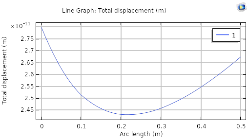

I am attaching the .mph file for this problem. This particular problem is analytically solvable. For such a small pressure difference, the displacement of the outer boundary should be tiny. When I solve, I see this is actually the case. One of the attached plots is the calculated displacement along the radial direction. The reported displacement is negligible.

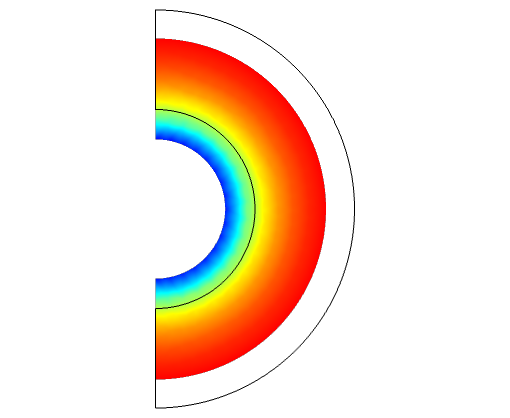

However, when I display the 2D and 3D models of the stress, it looks like the whole model has been compressed by 20 cm in the radial direction (see attached figure). When I set P_1 = P_2 = 0, there is no compression (but also no stress field), however any nonzero pressure difference is giving me these crazy nonphysical distortions of the body.

Good news: You are not doing anything wrong. The deformations are scaled in that plot; the scaling factor is chosen automatically such that the deformations are visible to our naked eye. Change that scaling factor to 1 if you want them represented at their real magnitude - but of course you will no longer see them because they are very very very small.
Hello True, Good news: You are not doing anything wrong. The deformations are scaled in that plot; the scaling factor is chosen automatically such that the deformations are visible to our naked eye. Change that scaling factor to 1 if you want them represented at their real magnitude - but of course you will no longer see them because they are very very very small. Jeff
