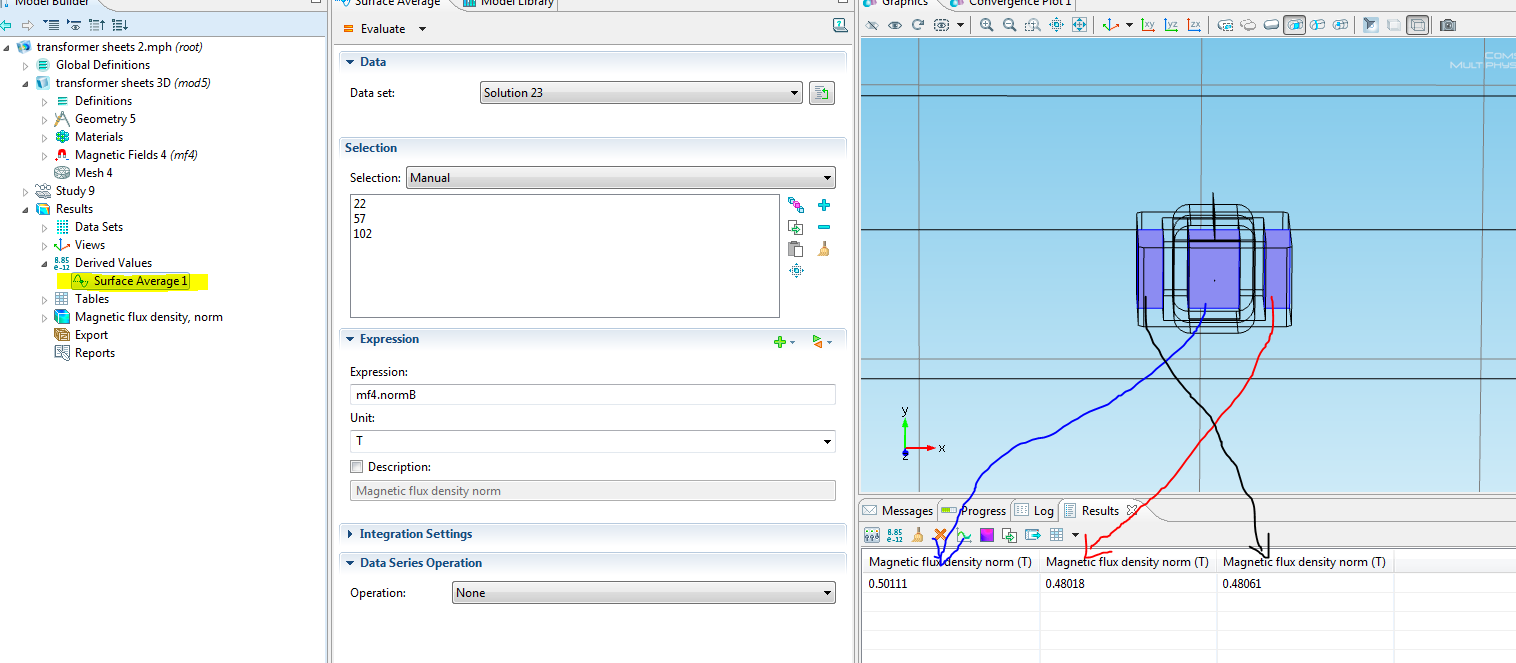

Hello everyone,
i´m trying to observe the magnetic flux density in a smal gap of some transformer sheets. So far building the model and getting results that are in consent with my experimental setup was not an issue, after reading half of the posts in this forum. The magntic flux density in my air gap is ~300mT wich the simulation kind of confirms. My problem lies in the distribution of the magnetic flux density inside of my transformer sheets. The right and left side have different values for the magnetic flux density. The geometrie is symmetric which should eliminate the possibility of creating a shorter route on one side.
I hope anyone got some suggestions for me how to explain this or some tweeks to eliminate it.
