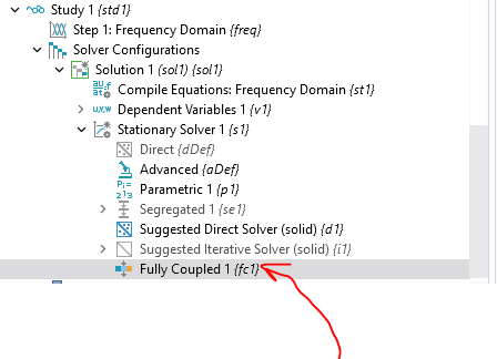

In the model, there are no frequencies listed in the study step. I am not sure what frequency you are solving for as this may affect the convergence. With regard to the error for maximum number of segregated iterations, you could try switching to a fully coupled solver. This should be more robust.

Dear Mark, thanks so much for replying me, it actually works in the first mph file called mylastone.mph attached in the first post even though PARDISO switched to out-of-core mode. Is there another way to simulated these local resonators instead of using the following setup: In Lumped mechanical module: displacement node where input disp. is from muticoupling, spring, mass and free node connected in series defined as subsystem. i thought another way where displacement node is set in the same way but i add external source between mass and the free node where for the first port i have used intop1. and for port 2 i set 0 as displacement since is free node. the issues is that intop1 can only that one component of the displacement as intop1(u) but i need 2 displacement intop1(u) and intop1(v) since i m considering both direction in the x,y of my spring-mass system . i thought i add another external source with the other component but it's not working.
