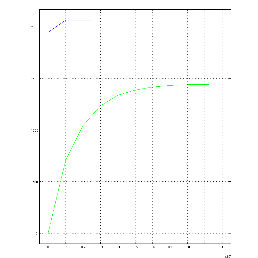

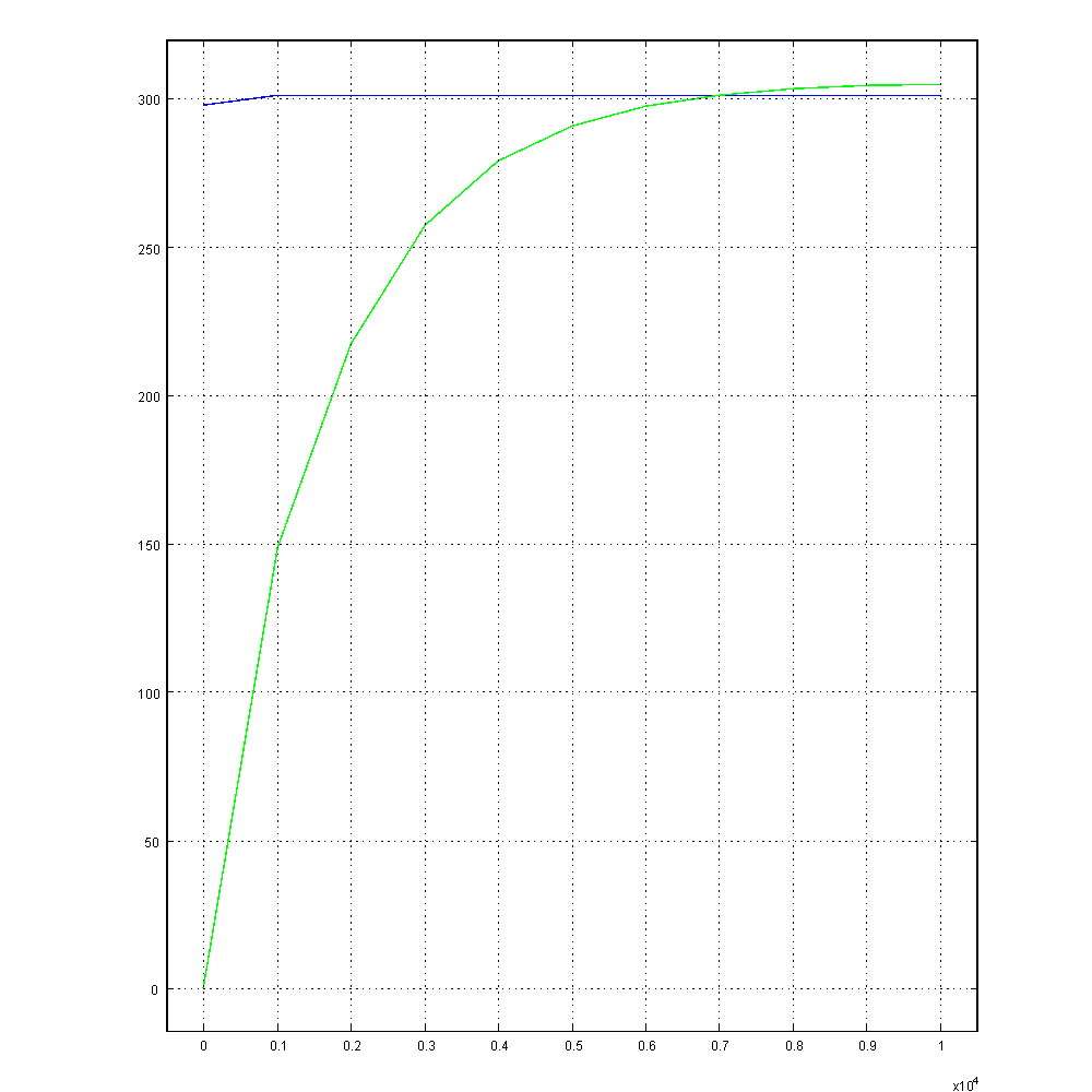

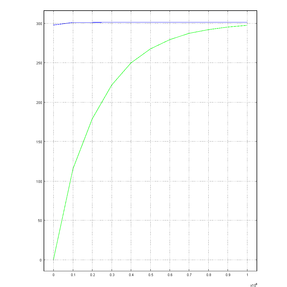

I have attached two png files of not so bad solutions comparing hemispheres (good converging fluxes) and spheres just above the surface (moderately bad solution). It gets much much worse with acute angles and ellipsoids.
EDIT: Added an ellipsoid solution.. you can see the fluxes stabilize at wildly different values, yet the concentration in the box stabilizes.. this is obviously not physically possible with more molecules coming in than going out.
EDIT2: Realized that I was using total flux magnitude instead of normal total flux.. I am not clear on what exactly total flux magnitude is then. The results are 'more' realistic now but the fluxes still do not sum to zero
