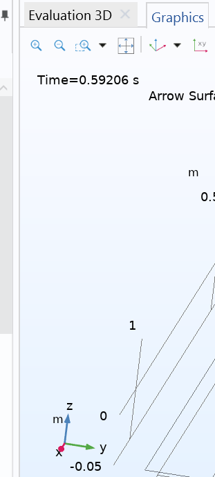

In time dependent analysis there is a time label as in the attached. How to turn it into sth like time=T/3, time=T/2 that depends on t/T? Here the time domain t=[0,T], where T is a parameter.

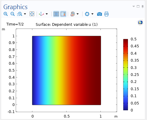

Yes, with a manual plot title with the Parameter indicator set to Time=T/eval(T/t) you should get that type of label, if the time steps are fractions of T (see the attached screenshot). I would advice against the use of T for the final time if a heat transfer interface with a temperature T is included in the model.
Hi, Yes, with a manual plot title with the **Parameter indicator** set to `Time=T/eval(T/t)` you should get that type of label, if the time steps are fractions of `T` (see the attached screenshot). I would advice against the use of `T` for the final time if a heat transfer interface with a temperature *T* is included in the model.
