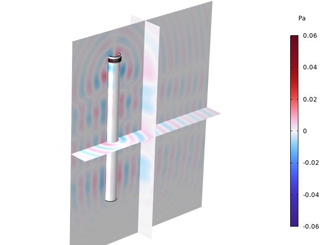

The first model attached here solved in ~20 minutes with about 20 GB RAM for me, which is not bad. The screenshot shows the acoustic pressure from the vibrating structure.
