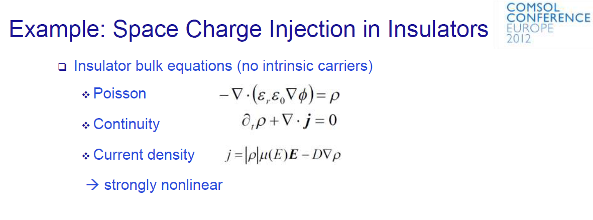

I am beginning to get the hint that the EC is not for insulators or semi-insulators, but how is one supposed to model a (not completely) insulating material, then? Seems to me that there is an option for if the charges are static (ES) and then if the material is > 0.1 S/m you can have a current with the EC. Is there any option for anything in between? Or is there any kind of option for connecting them? I'm sorry if this question is completely naive.
I noticed in a presentation by Christen on the Comsol Conference that uses the Poisson and Continuity Equation together. I've attached a screen shot of the slide. Is there any way I can attach an equation to the ES that will allow for a little bit of current to flow? Maybe this suggestion is completely off base, but I am just trying to figure this something.

I would say that in your model with the copper conductivity of 6e7 S/m and the nylon with 1e-1 S/m it IS just a little bit of current in the 'insulator'. You have 8 orders of magnitude in the model. You could try now to tweak the solver to increase the span.
Which specific question to the model remains unanswered? I don't think the publication you cited is applicable to your question.
