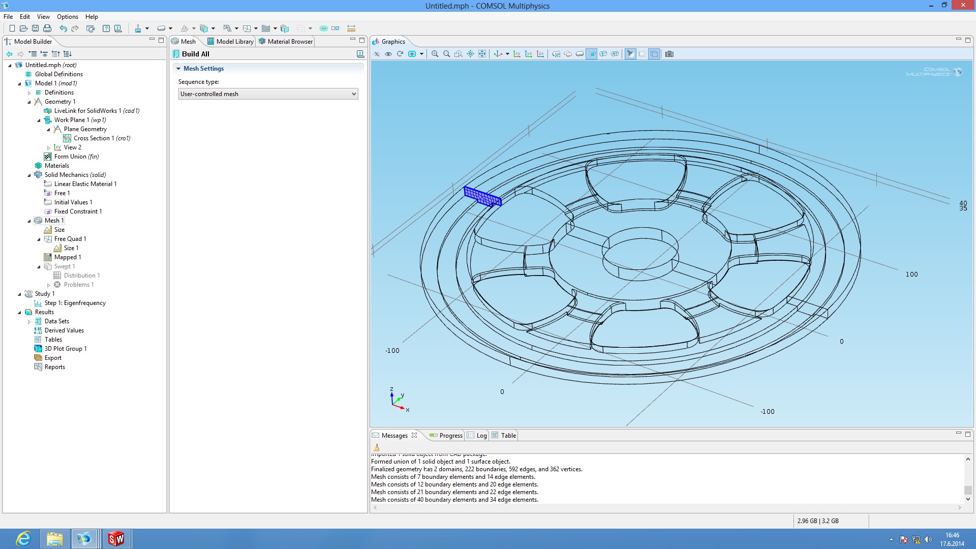

I have one similar problem with meshing cilindrical elements which have spokes in circular direction (like a wheel rim). The problem is that when I do a section cut a try to mesh segments of the element, the sweep tool does not allow me to mesh tha circualr part and not try to mesh the spokes. It is probably a really common problem, but somehow I am not able to find anything similar in help or comsol community.
As Ivar wrote one way is to import assembled models from CAD, but in general this is a pretty longway when several elements are being analyzed and are already assembeld in a larger system.
Just to clarify my problem, I have attached a printscreen which shows very simple which segment I want to sweep in the first step and laso aims to which segments remain for next mesh nodes.

I would expect you can sweep your section if you "split" your volume such that you have a section of revolution for the outer and inner rim parts, then you would need either thets for the spokes, or try a structural surface mesh and sweep the spoke in the thickness, but you need as many mesh elements in the thickness for both inner and outer rims.
Another way, as you part is symmetric, would be to cut it into "pie" slices, and to separate the domains into outer rime entity, spoke and inner rim entity, then create the full volume by mirror and copy operations, and repeat the same for the mesh (mesh a section, then copy mirror the mesh all around
Then main limitation, sweep meshes cannot easily go around complex topologies with loops, you need to cut your domains into smaller items and handle them separately by programming manual mesh steps
