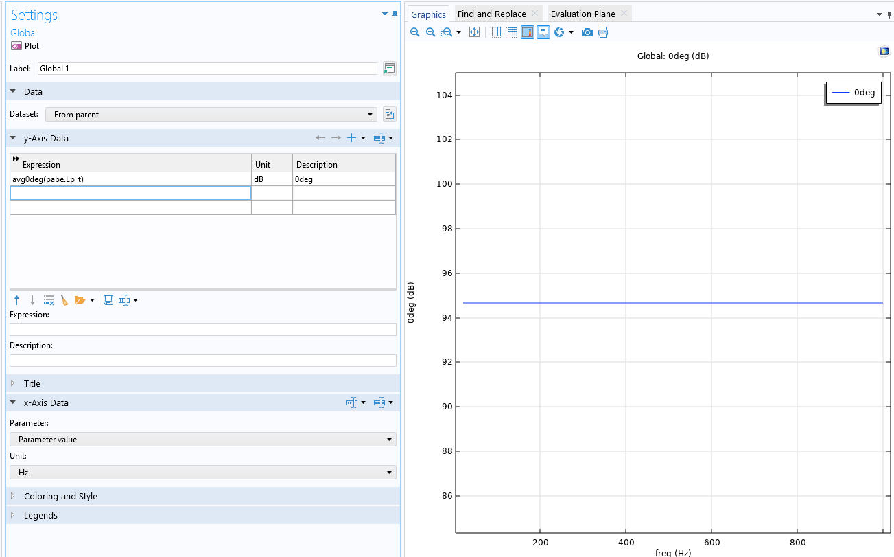

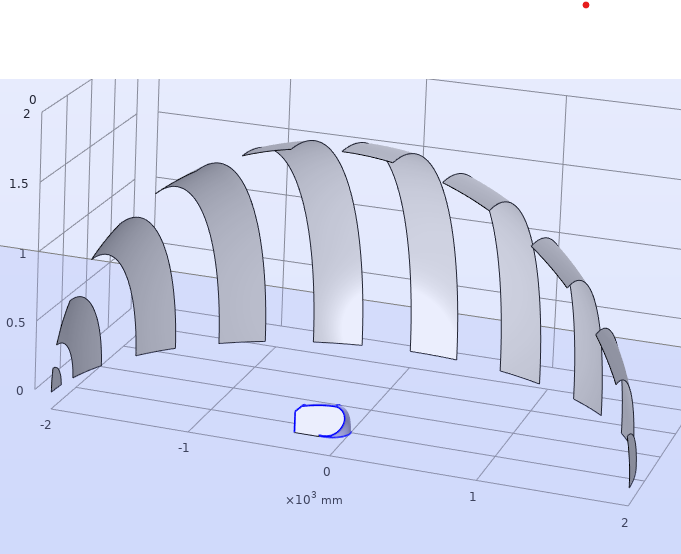

I have tried to mesh the points and lines (when rotate) around the loudspeaker and use the average nonlocal coupling to evaluate pabe.Lp. i have also given these points air as material. Unfortunately the sound pressure level is not correct as it is constant and does not change with frequency.

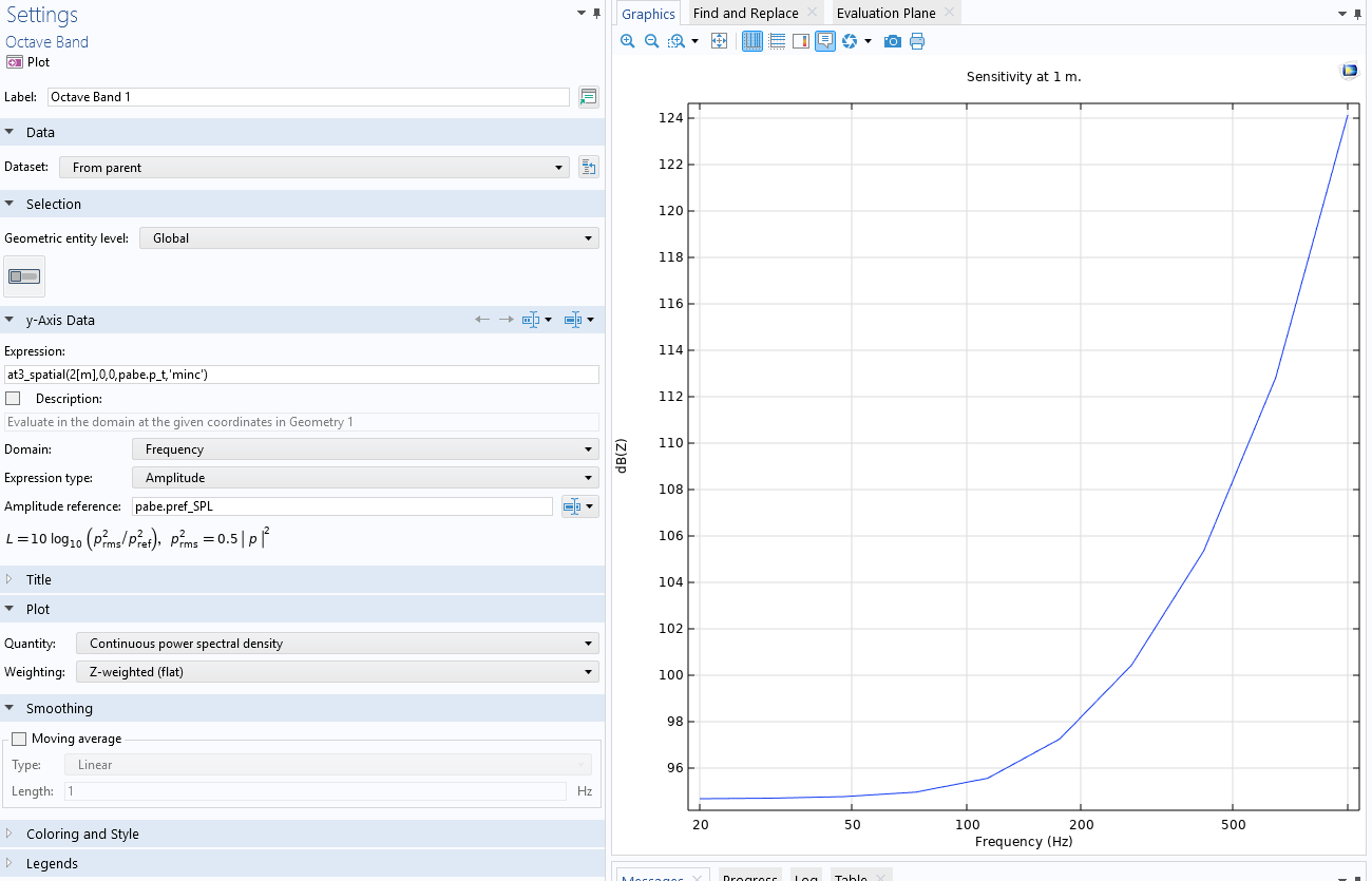

When I evaluate - Expression: at3_spatial(2[m],0,0,pabe.p_t,'minc') as 1d plotgroup and as octave band it works. It is the correct solution (same as in FEM 2d axissymmetric solution)
When I evaluate at3_spatial(2[m],0,0,pabe.Lp,’minc’) as 1d plotgroup in a global evaluation it does not work in any combination.
Evaluation avg0deg(pabe.Lp) gives me a flat line though it should be the same as the octaveband.
How can I evaluate sound pressure at specific points or as averages over lines? Is there any ways to correctly include the meshed points i used?
