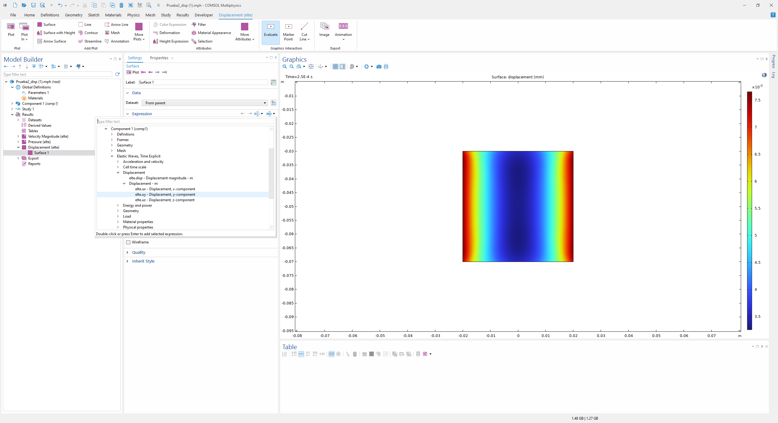

Posted: 2 years ago 10 févr. 2025, 17:23 UTC−5
It's the displacement in the y direction, see the attached file.
It's the displacement in the y direction, see the attached file. Best, Jeff
