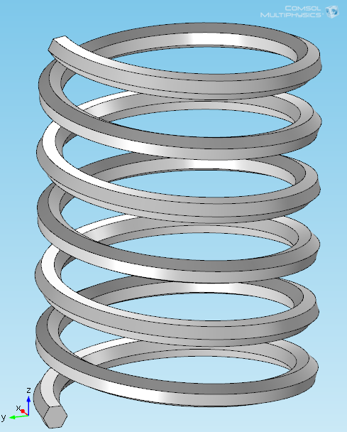

I used the build-in "helix" one but that was with a circle cross section while what I want is actally not that simple.
Thanks for any feedback!
Use Parametric Curve and Sweep options to create helix of arbitrary cross-section. Example is shown in the attached file.

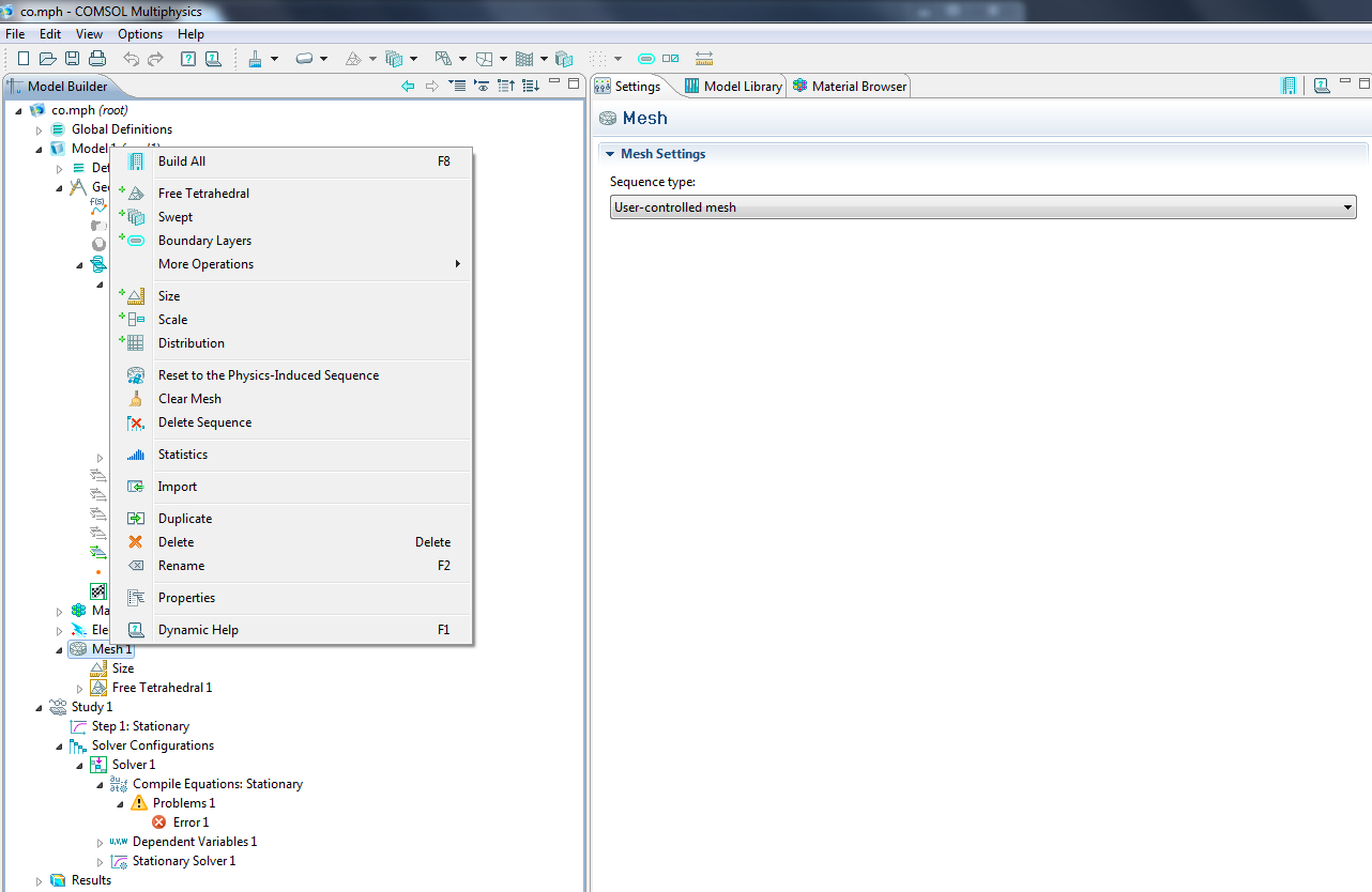

But I didn't see "dimension" sub tab on the mesh node(see attachment)... Or is it possible to use a for-loop directly in comsol?

sorry my fault it's "Distribution",
read the doc about the mesh nodes, its important to understand in which order you call them and the difference of a major node and a sub node, performing a few of the model library examples helps too, at least those (or the video) about the meshing

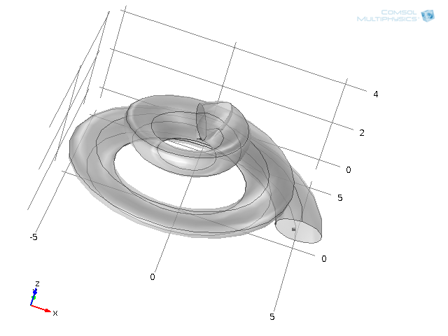

There are two parts that I need help in my model attached.
~ How to taper the cross section along the parametric curve to avoid overlap of material (in current model I increase the radius and height to avoid it which is non-realistic), supposing I know the tapering function
~Is it possible to extrude the workplane in the direction of the curve without any twist. i.e. the corss section is always perpendicular to the base plane(xy-plane). just like the attached image, I think it might be achievable. Otherwise, since I don't know the function of twist. It would be impossible to track the path of a specific point of the workplane which is actually very important for me.
It'd be very nice of you if you can offer some solution/idea. Thank you very much.

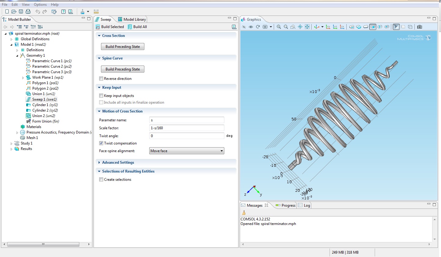

I manged to get a tapered helix by putting 1+f(s) (where f(s) is the function of s required) in the scale factor box.
Im not sure what the scale or bounds of 's' are or where you would find these
Thanks for your information. I'd like to see how it goes. Unfortunately I couldn't open the attachment cuz I am using COMSOL 4.3a and it just gave an error "Model created with a later version of Comsol". Can you please fix it or can you just send me some snapshot about the settings. Thanks in advance.
JC
I dont know how to save as a previous version so here is a screen shot the important bit seems to be the 1 in the scale factor box.
