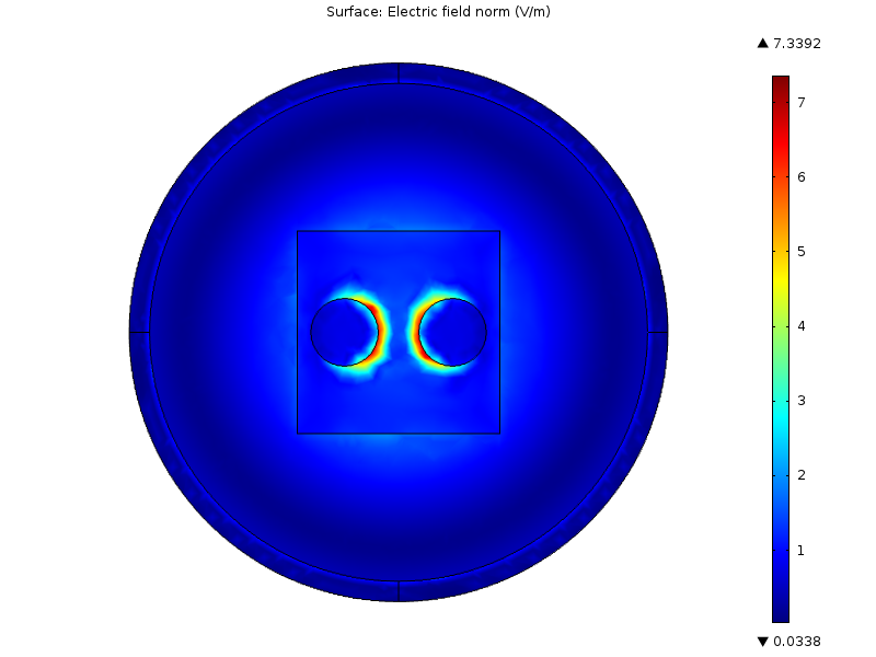

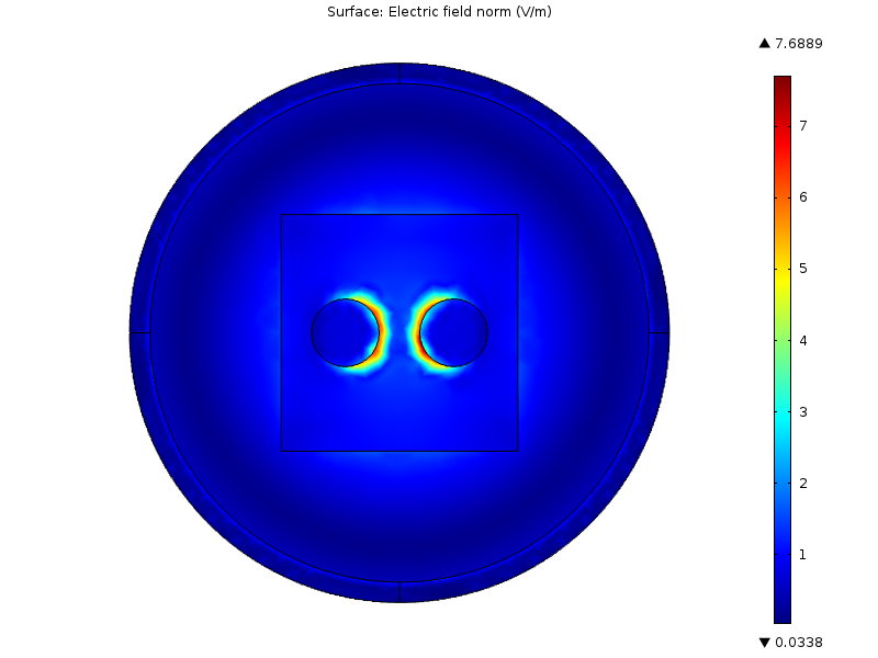

Hi, i am a student in republic of korea.
My model is to observe how E-field enhancement is made by constructing nano gold patterns on a slica galss, applying incident laser from z-axis. However, I have a question which is that why the results are different between applying a big base silica galss and a small one during my modeling. I think if I do same pattern models, base size is unrelated to the result. but in my model, e-field enhancement to which a big slica glass is applied is bigger than e-field enhancement to which a small one is done.
so, my question is
" why are they different? "
" If they are naturally different, what is the reason? "
" or my modeling is wrong, how can i modify? "
thanks.
p.s. two model images is added ,

I wonder if it could be linked to your mesh (looks slightly coarse in the high gradient region and perhaps some modulation artefact from the graphics rendering.
Have you checked that your results are mesh insensitive ?
Hi I wonder if it could be linked to your mesh (looks slightly coarse in the high gradient region and perhaps some modulation artefact from the graphics rendering. Have you checked that your results are mesh insensitive ? -- Good luck Ivar

First of all, thanks to your reply, but I applied simple mesh because finer mesh, longer simulation time.
I used 785 nm laser, what should i do mesh setting?
Hi, First of all, thanks to your reply, but I applied simple mesh because finer mesh, longer simulation time. I used 785 nm laser, what should i do mesh setting?

clear finer mesh take far longer ;) But check the RF doc about mesh density and wavelength resolution, + model size aspects, then you could try to double the mesh density and see if the results change a lot or not (>10-20%) in which case you should use a finer mesh. Now it could be that you can concentrate the mesh only where the dependent variable gradients are strongest
Hi clear finer mesh take far longer ;) But check the RF doc about mesh density and wavelength resolution, + model size aspects, then you could try to double the mesh density and see if the results change a lot or not (>10-20%) in which case you should use a finer mesh. Now it could be that you can concentrate the mesh only where the dependent variable gradients are strongest -- Good luck Ivar
