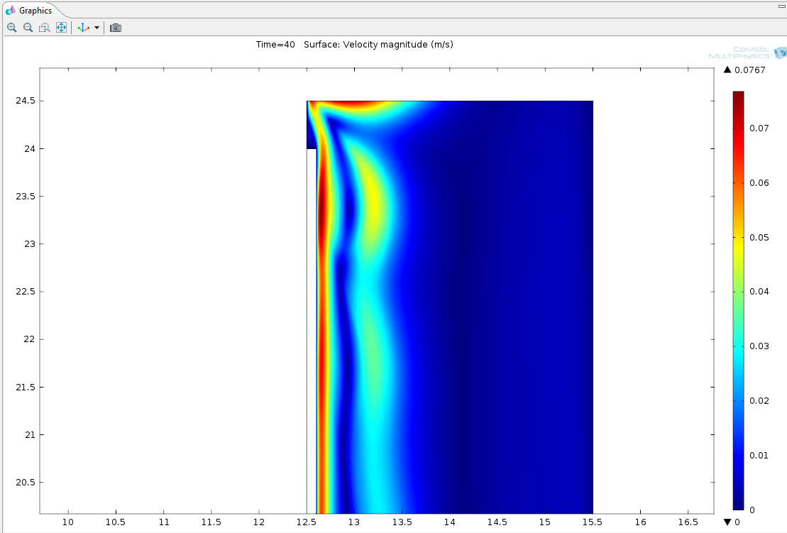

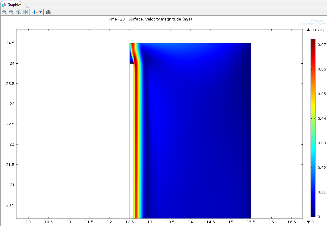

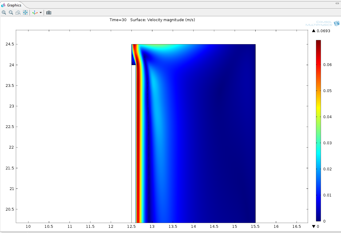

I additionally tried using segregated solvers (2 segregated solvers 1 for pressure and velocity and 1 for temperature). I have read this should help solve highly nonlinear problems. But again after about 30 seconds into the transient solutions, the solution fails.
Edited: I added some of the solutions so readers do not have to open and run the model. Solutions are plotted for times 20, 30 and 40 seconds into the simulation.
