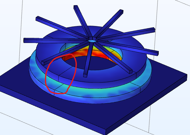

I wish to change the circular coil to hexagonal in 3D. Take a look the 3D design,
Suggest me what to do in Geometry>workplane>plan geometry>rectangular .

Hello Md Mubdiul,
To create a regular polygon, such as a hexagon, in a workplane, from the workplane's Plane Geometry node, use the Parts > Parts Library > COMSOL Multiphysics > Regular Polygon tool.
Once you've drawn the hexagon in the workplane, you can use an extrusion to turn it into a hexagonal cylinder. Best,
