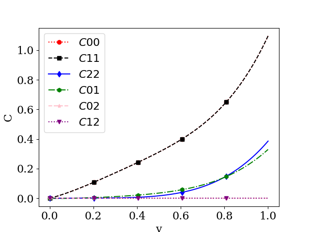

Thank you for your reply . I'm trying to match the values as obtained in this graph , which is from paper I attached. Somehow the values are not matching for lower volume fractions.

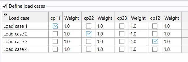

Thank you for your valuable suggestion. I'm able to match the values now, except for one value C22 which is basically C33 in COMSOL (elasticity matrix) .I think it has got to do with loadcase settings .I'm attaching you the Boundary condition and Loadcases I'm using .This is for 2D study.Please let me know if any change is required in this .
Regards, Manoj

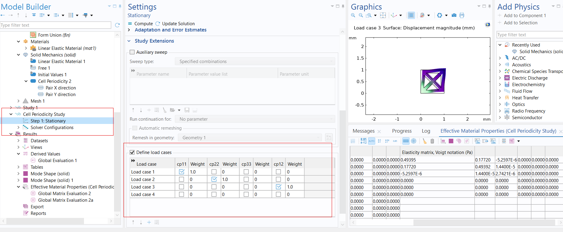

How did you determine the values of Cij?

Thank you for your reply. I ran for 3 loadcases and measured Cij in Elasticity matrix voigt notation . I'm attaching screenshots for both.

In curve 4 of GM-TOUNN... pdf, he plotted the curves for the case of X-shaped cells, it is not the same as your case.!
Regards, Manoj
Hi Manoj,
Yes it has to do with the loadcases and cell periodicity settings. Manually remove the auto created model nodes and regenerate again. My advice it first try to build a 3D model and then use that model as a reference to build a 2D model.
Regards Amit
