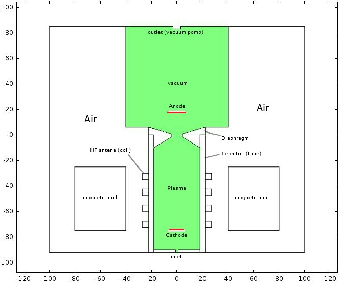

I'm creating a plasma with a Inductively coupled plasma and laminar flow interface.
I want to put the electrodes (anode and cathode) in the model (within the device) and apply voltage to the electrodes, which would measure the resulting current.
to need it Ballast resistor or another same. in AC/DC module (electrostatics or another interface) there is no Ballast resistor options.
please tell me, how can I do it?
in DC Discharge there is such a possibility but it's interface is used to create the plasma and not possibility use the Inductively coupled plasma interface and DC Discharge interface in one model at the same time.
