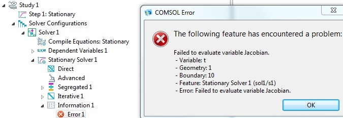

I think I have made the Vac, but I got into trouble in the simulation just as the figure error shows.It tells me that: "Failed to evaluate variable Jacobian. —Variable:t —Geometry:1; —Boundary:10 —Feature:Stationary Solver 1(sol1/s1); Error:Failed to evaluate variable Jacobian "
Could you give me some directions about this please? And actually I just choose the stationary solver and I think that you're right. But I'm sorry that I don't understand your suggestion about the solver, could you describe it a little more detailedly please?Thank you!

first, in a stationary case, use rather something else than "t" as it's a reserved variable for COMSOL, except if you are preparing a t=0 or t=cte value for a later transient solver for t>0 or t>constant
The Jacobian error means that the definition you have given to "t" is not continuous, and the solver needs continuos fields to be able to derive them for the solving process

You said that the Jacobian error means that the definition you have given to "t" is not continuous, I didn't find the place where I make "t" continuous.In the Global definition,I define the Waveform and Analytic function,and I made the Arguments be "t". I use this way to add the harmonics, and also get the error:failed to evaluate the Jacobian .So could you tell me how to make it continuous please? Thank you!

the variables in the function definitions are dummy names, not linked to anything from the model.
Then it must be that your functions, as defined, are not continuous
