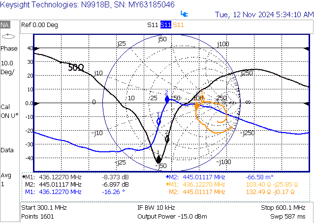

I managed to get negative S11 values. Though it doesnt seem to go as deep as the reference project suggests.
![https://gusbertianalog.com/content/images/2024/11/MEAS_ROUND_CCC.png]
https://gusbertianalog.com/loop-antenna-design/
Upon examining the lumped port dimensions, i believe the height is the distance between conductive boundaries, and the width is the perimeter of the conductive area.
I'm also not sure about how to include the surface current density, if im taking into account skin effect of copper wire. Also I'm not sure if the value is A/m or A/m^2.
I've uploaded the file. I managed to get negative S11 values. Though it doesnt seem to go as deep as the reference project suggests. ![https://gusbertianalog.com/content/images/2024/11/MEAS_ROUND_CCC.png] https://gusbertianalog.com/loop-antenna-design/ Upon examining the lumped port dimensions, i believe the height is the distance between conductive boundaries, and the width is the perimeter of the conductive area. I'm also not sure about how to include the surface current density, if im taking into account skin effect of copper wire. Also I'm not sure if the value is A/m or A/m^2.
