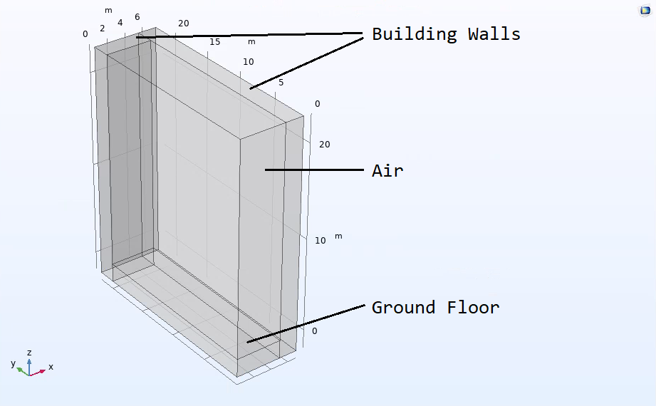

For simplification, I modeled two (outer) walls of a building, a ground floor and the air above. Note that the ground floor and the air are supposed represent the outside of the building.

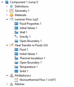

I wasn't able to reduce my .mph file to the required < 5 MB in order to upload it. If someone here would like to look at it anyway, I will gladly find another way to upload it somewhere else. For now, I will list the most relevant information below and include another screen shot of my model tree to give a basic idea of my physics module usage.

=============== Additional information: * Irradiated surface temperature: From my previous model using only the ht and rad modules, I recorded the resulting average wall and ground floor surface temperatures throughout the simulated day duration to a table. In my current model, I use this table to statically set the surface temperature for each simulated point of day. I do this over the ht > Boundary Temperature node. The range is from 12 °C to 55 °C. * Distant air temperature: In order to represent the temperature of the surrounding air, I similarly set the surface temperature of the air at the outer edges of my model through a simple diurnal cycle ranging from 12 °C to 27°C. * Mesh: I use a physics-controlled finer mesh. * Study: I use a time-dependent study with the following output times, in seconds except where specified differently: range(0,0.1,1), range(1,1,10) range(10, 30min, 23.5h)
