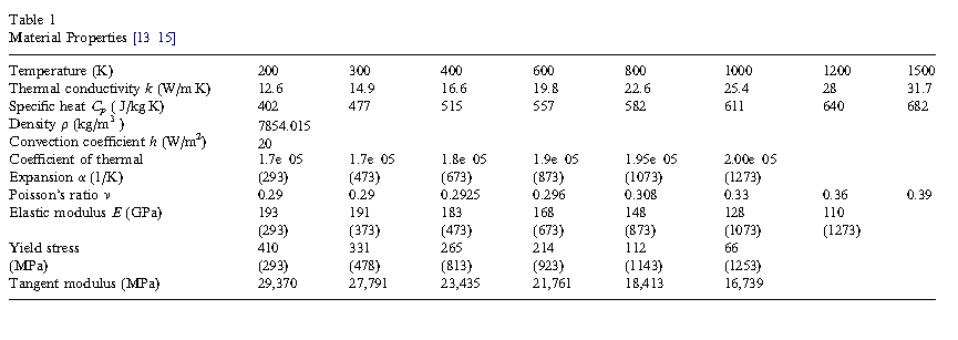

i have analysed thermal stress by passing the laser beam on rectangular plate (through structural mechanics module).i used stainless steel temp dependent material properties to my simulation. i used elasto plastic properties yield and tangent modulus. i have attached the properties also.i satisfied with results of deformation of plate and temperature profile. but my major problem is von mises stress exceed the ultimate stress level.
how can i reduce the stress value??

Thanks for your reply.i used temperature dependent properties by using interpolation function.but i am getting 700mpa von mises stress .but stainless steel ultimate tensile strength is 515 mpa.

sorry for my explanation. this is my final result Von mises stress value about 700 Mega Pascal. von Mises stress I got from Comsol too high (>>yield strength of materials) than I expected.

The ultimate tensile strength of the material is not accounted for in the elastic-plastic material model you are using. Therefore if the strains are high enough you can get stresses around 700 MPa. That would require a very large temperature increase though and an overly constrained structure. What temperature increase are you applying? Check also that you are using an elastic-plastic material and not just elastic.
