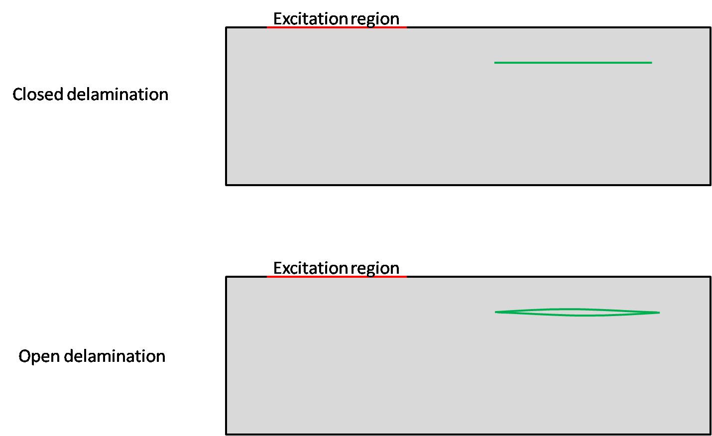

I would like to implement the clapping effect of a delamination (suppose in 2D). The sample is a rectangular composite. At the top side of the sample a continuous sine wave is excited. Inside the sample a delamination is included (see attached figure).
The problem in this simulation is how to implement the boundary conditions at the delamination. The delamination can either be opened or closed. Therefore I need a boundary condition which varies in time.
If a certain stress value on the delaminatino boundary is exceeded, the delamination opens. In that case their is a gap between the two faces of the delamination and at both faces stress-free boundary conditions has to be assumed.
In the case the two faces of the delamination tend to overlap the delamination is closed and continuity between the two faces is assumed.
Note that it should also be possible that the delamination is open at some points and closed at other points.
