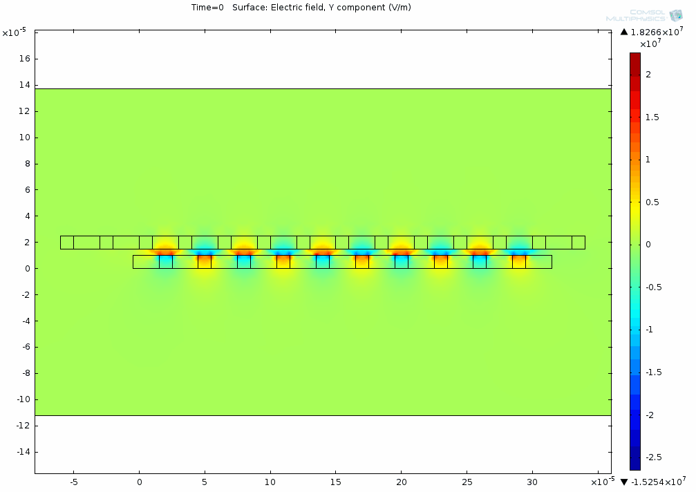

If you use ES+ALE, you should use 2 parts for correct movement. Else your mesh will be strong deformed due to large motion.

                                                    Thanks Ralf! I took the changes from your file and it seems to be working properly now.

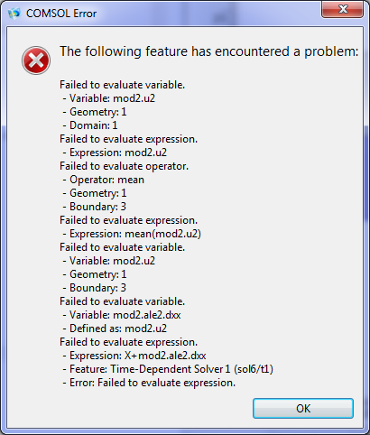

I have tried to incorporate solid mechanics with the previous model in order to apply a body load. Then I used the displacement (u) from solid mechanics as the mesh displacement for ALE but am I getting an error as shown in the attached figure. I tried applying the mesh displacement to only the device (not the air) and there were no errors but the electric fields weren't changing again like in the original model. So I believe the problem is that only part of the mesh (the device) has a displacement (u in air is zero).
So is there anyway I can express the displacement of the whole mesh as the displacement (u) of just the device? Or is this a totally different issue?

What should be the result of your simulation? If you want to see the mech. stress of your lower part, you can add a second study only with solid mechanics and use the same predefined displacement as in the first model.
In other case you can use your own differential equation (ge) like F=m*a for the movement.
Ralf
