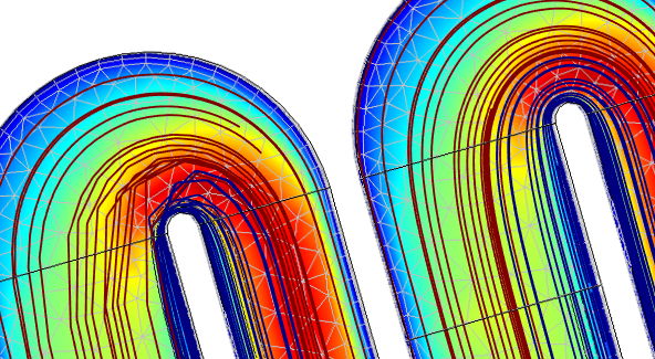

Also, I have experienced something odd, in my own model which is a periodic structere (spline) where I have mapped the velocity field solution from one unit onto the other units in the geometry. I then used this mapped solution in a particle trace study with massless particles. In the first loop/arch of the spline, the particle trajectories are jagged and weird, while in the next, they are nice and smooth (see the attached snapshot), even though the fluid fields they move in, and the time steps used in the solver, are completely identical. What is happening here?
I hope someone can help me.
Best regards
Signe
