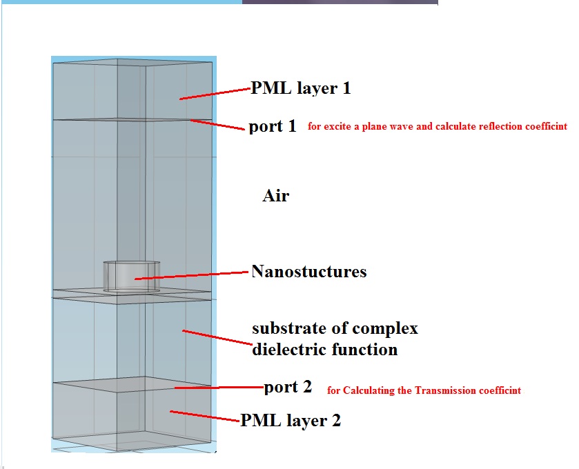

Thanks a lots for your answer,
I have a small query regarding the above issues.
i want to simulate a system having periodic nanostructures placed in substrate of complex refractive index also calculate the reflection and transmission coefficient at top and bottom layer in visible range. for that i need to define port , and also appropriate PML layer which will takes care of all unwanted reflection and transmission from the structures. now i am attaching my simulation model in the attachment file.
step followed for simulating my model as below
1. Define all parameter and also built the geometry. here also I am facing problem for uploading the txt file for defining material properties (real and imaginary part of refractive index) through interpolation function.
2. Define the PML layer and identity pair at top and bottom layer.
3. While define the plane wave as the excitation source at the identity pair which is the interface of air top surface and bottom surface of PML layer1 , but it was not taking in the option menu. Could you suggest me what will do for this. currently I am using Comsol 4.3 version, earlier in 3.5 it had been taken in nice way but 4.3 version i dont know where is the mistake.

Here i have attached my model below.

The picture looks reasonable but it doesn't tell what might be wrong in the model.
How are you treating the lateral boundaries? You may need a periodic BC there.

Seems, you are using Form Assembly + PML options to avoid back reflection from the exciting port. This is old approach used in version 3.5. In Comsol 4, different approach is used which doesn’t require assembly and identity pairs. Generally, you almost never need to use Form Assembly option anymore in RF Comsol 4 version. The approach to solve grating type problem in new version is illustrated in the following example model
www.comsol.com/showroom/documentation/model/10032/
Steps to upload real and imaginary parts of the refractive index are described in the following example model:
www.comsol.com/showroom/gallery/12415/
