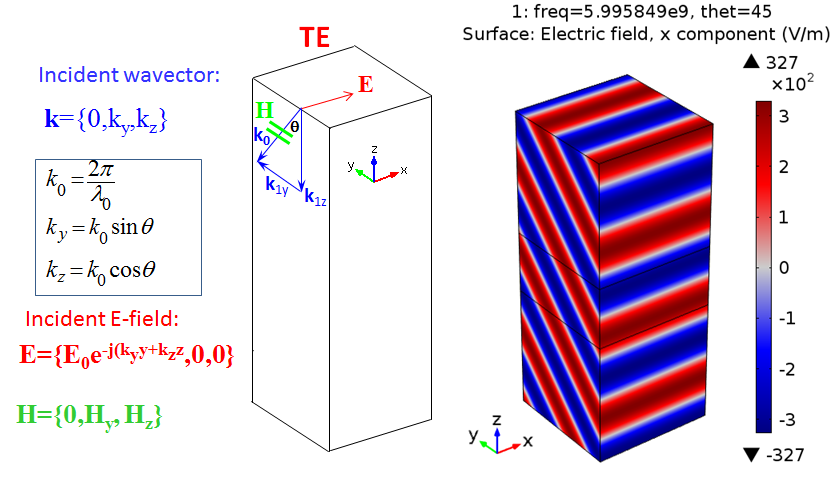

Posted: 1 decade ago 4 avr. 2013, 13:12 UTC+2
Constantinos,
For x-polarized wave, incident wavector is
k={0, k0*sin(theta), k0*cos(theta)}
and incident electric field is
E={E0*exp(-j*(ky*y+kz*z)), 0, 0},
as shown in the attached picture.
Sergei

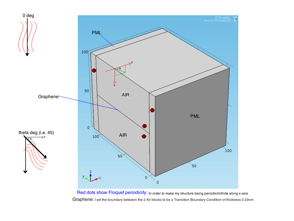

In the example above, the wave is tilted with an angle with respect to YZ plane.
However in my case I want to shine light with angle with respect to XZ plane.
I am sending you the results of what you told me to put in the model, in order to check if I did things right.
And also am sending you the model's picture with the light I want to shine in my way.
The model is meant to be a graphene stripe which is infinite along x direction but having a finite width along y direction.
I want to produce plasmons and in order to produce them I must have a kx component that matches plasmons' k-vector that is parallel to x-axis.

1. I don’t think that the way you placed PMLs will perform as non-reflectinf boundary for various reasons.
2. Port setting is not correct. Since the wave vector is in the x-z plane, you have two options for EM field:
(a) E={Ex, 0,Ez}, H={0,Hy,0} which corresponds to TM polarization for ports at planes z=const
(b) E={0,Ey,0}, H={Hx,0,Hz} which corresponds to TE polarization for ports at planes z=const
Accordingly, you can set up port by specifying magnetic field for TM polarization, or electric field for TE polarization.
Your expression abs(kaz+kay) for propagation constant has no physical meaning. Propagation constant should be specified as the component of the wavevector which is normal to the port boundary.
I would suggest take close look at the “Fresnel Equations” model from Comsol RF library and make sure you have clear physical understanding of port set up for TM and TE polarization cases. Also, this model illustrates how to use PEC or PMC boundary conditions to model infinite extension of the modeling domain in one direction depending on the wave polarization. After that, you can use this model to introduce Transition Boundary condition at the interface between to domains to represent your grapheme layer. After that, search Comsol conference papers about modeling surface plasmon propagation. I suspect, that what you are trying to model resembles classical Kretchmann-Raether configuration of plasmon excitation.
Sergei
