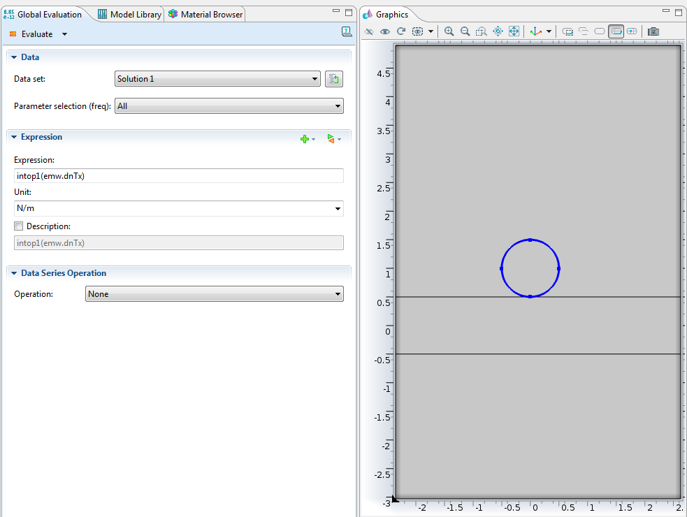

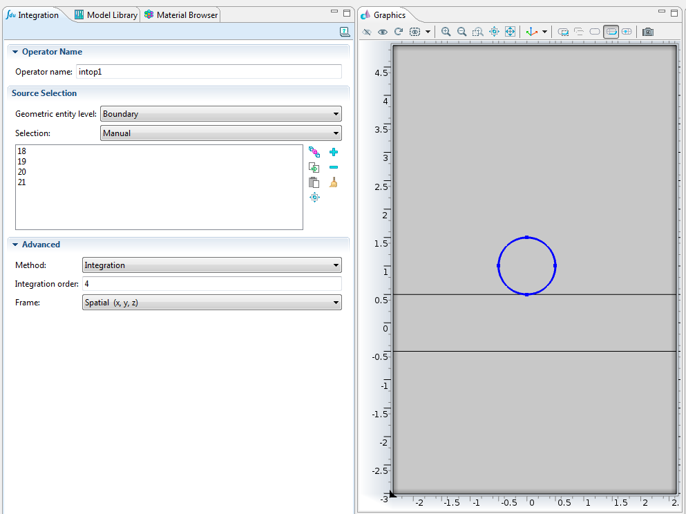

When I do this I get a force/m which is a few magnitudes smaller than what you get. I think my integration might be incorrect. If I understand correctly I want to integrate over a surface with the normal point radially outward from my sphere in 2D. A line integral will only integrate along the line. If I use a surface integral in 2D it doesn't seem to make sense to me.
I've attached pictures of my attempt but I don't know how I can get Comsol to do what I want. When I do this I get a value of 2.8*10^-10 N/m

when you perform a 2D simulation, the default depth is 1 meter (for the 3rd dimension as COMSOL calculates always in 3D in the background), hence all surface integration need to be multiplied by the true depth to give absolute values, else they are expressed as "per meter" hence the N/m
for 2D-axi going from surface integration to volume integration requires to multiply by the "loop length" hence by 2*pi*r
Hi when you perform a 2D simulation, the default depth is 1 meter (for the 3rd dimension as COMSOL calculates always in 3D in the background), hence all surface integration need to be multiplied by the true depth to give absolute values, else they are expressed as "per meter" hence the N/m for 2D-axi going from surface integration to volume integration requires to multiply by the "loop length" hence by 2*pi*r -- Good luck Ivar
