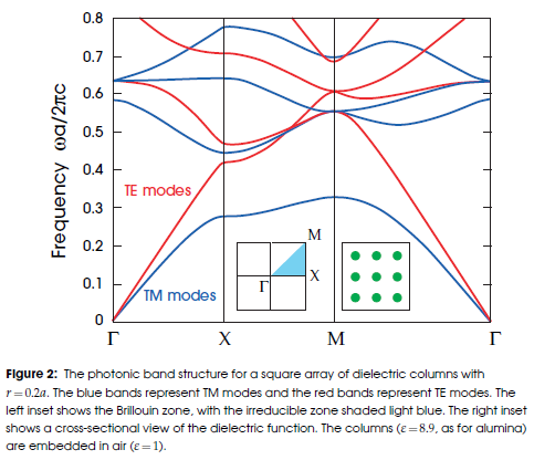

Thanks for your reply Chris,
I already figured it out with the double Floquet BC's which indeed allows me to solve for the eigenfrequencies - but only if i leave out the ports alltogether.
Anyways, i am trying to reproduce the results in the attached band diagram (using the same parameters). If i have ky = 0 and sweep kx from 0 to pi/a, this should correspond to the Gamma -> Chi segment in the diagram. As i compare my results with the reference they match pretty well, but it seems like i only get the TM solutions out. What if i want the TE solutions as well? I don't understand why the periodic BC's would restrict the polarization.
- Jens.

Ahh - i had chosen to solve for the out-of-plane component only, choosing the in-plane component obviously resulted in the TE-bands :)
Seems like everything is working then. Thanks a bunch for the inputs :)
- Jens

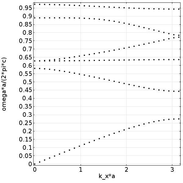

Hi guys,
Do we have to mention the source and detector? I got the eigenfrequencies but it doesn't match with band diagram Jens had given last post. What could be the problem? I didn't define any theta, just define kx=m*pi/a and ky=0 to get from CHI-GAMMA!!

Posted: 8 years ago 2 août 2017, 03:49 UTC−4
Hallo,
I am trying to find band diagram of a photonic crystal.My unit cell has periodic boundary condtion in x an dy direction .But z direction is open and also kz=0( no propagation).wave is only propagating in x and y direction.
PML and sacttering boundary condition has been used in top and bottom(open boundary).But the problem is the wave is reflecting back to the computational doamin.I have tried to increase the thickness and abosorption coefficient(scaling factor).But no improvement has been found.
I have also varied the distance of PML layer from the substrate and the thickness of the substrate from lambda to 10*lambda(to check when the eigen frequency become independent those variation).But no feasible conclusion could be made.
Could you please check the model or suggest me on boundary condiiton.
