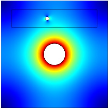

I'm new to COMSOL. I was trying to simulate the motion of a magnetic object due to external magnetic field.
The magnetic field is generated by a single wire, and I can get the magnetic force exerted on the object. But I don't know how to simulation its motion. Shall I use the time dependent study and ALE?

the electromagnetic physics does not include the "solid" physics so you need to add that, and as you say, if a geometry is moving you need the ALE to get the "air" mesh to follow the motion.
Be sure you put ALE first in the node list, at least BEFORE / Higher up than "Solid"
Hi the electromagnetic physics does not include the "solid" physics so you need to add that, and as you say, if a geometry is moving you need the ALE to get the "air" mesh to follow the motion. Be sure you put ALE first in the node list, at least BEFORE / Higher up than "Solid" -- Good luck Ivar
