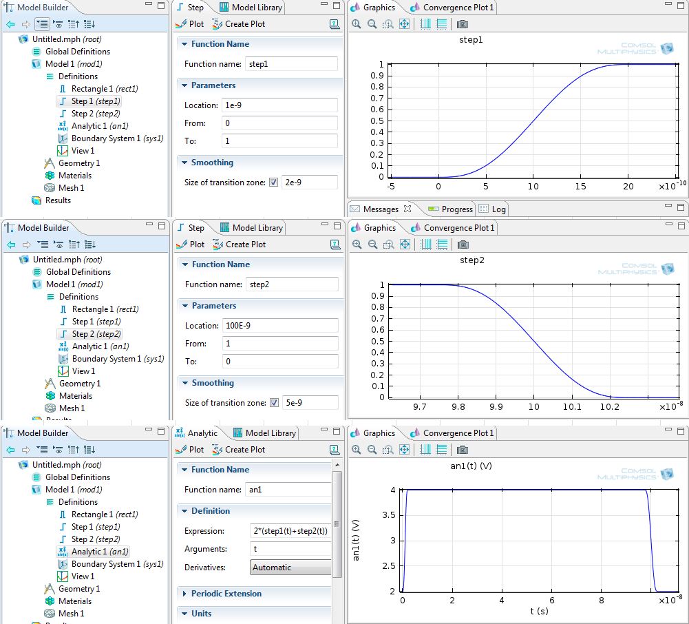

Alternatively, I have tried to use the step function
Step 1: Parameters >> Location: 0; From: 0; To: 1; Size transition zone: 5e-9
Step 2: Parameters >> Location: 100e-9; From 1; To: 0; Size transition zone 2.5e-9
And I tried to combined them into Analytic function: in the expression box: 2*(step1(t)+step3(t))

if you define the pulse as this (see file) it should be OK, but as you can define units in the analytical solution you do not need the units conversion when you call the analytical function, just use "t" as by default it's in seconds

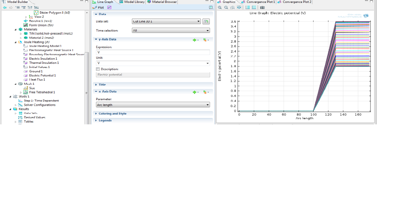

After I executed the prog, I realised that the potential (v) across my model varies with my Voltage (set:1.8V) [file]
This is what I wrote in Vo under the electric potential.
1.8*an1(t)
However, if I just apply 1.8V into Vo it shows linear voltage increase across my geometry from 0 to1.8V (Expected)
How can ensure my model is receiving a maximum of 1.8V and not beyond or varies? Do I make change in the analytic function? how?

that's probably my error, I normalised to 2"V" but as the two step functions go from 0-1 and they add up you will see that the analytical amplitude, in my example is 4 and not 2 as expected.
Check carefully the amplitudes and remove the factor 2 (or divide by 2 depending on how you want to normalise), it should work better

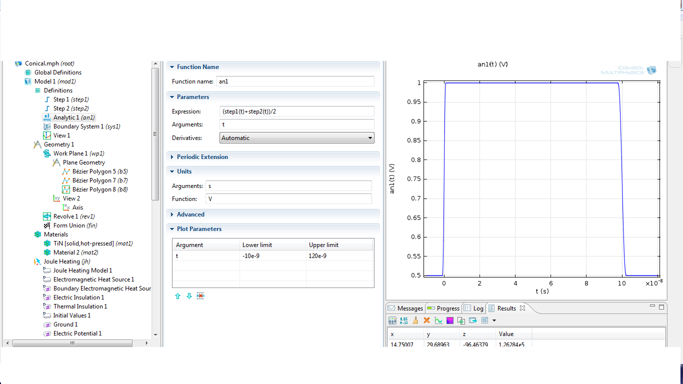

I tried to divided the expression by 2 [file: an1]. but it still cannot be scale to 0 to 1 in the y axis. Please advise.
but your an1() it scales to one, but the output is now "Volts" as there are units defined to the analytical function.
If you set the amplitude in your equations then keep the v0=1.8[V] outside and remove the "V" for the units in the definition of an1(). Hence it gives a scalar function of "t" between 0-1
