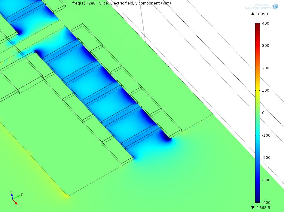

I have attached screenshots of d(V,y), and Y component of E field, respectively, plotted in the same plane. From my understanding, these should be equal, which is clearly not the case in my simulation.

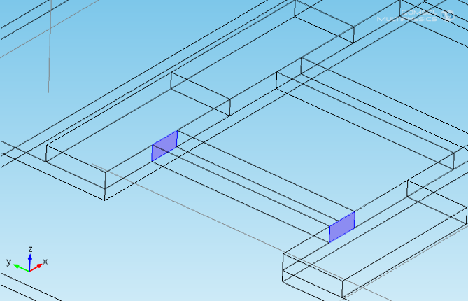

what about integrating the average voltage on both ends (=boundaries) of your resistances, and taking the difference ?
I have marked the boundaries that i probed for the voltage measurement in the attached image.

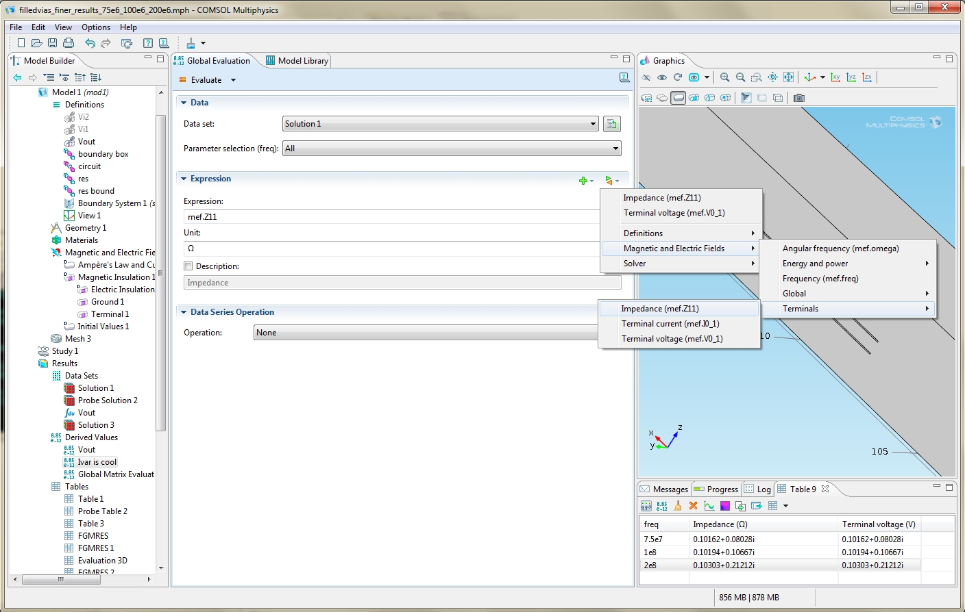

I didnt check, but what C did your terminal calculations give?
The lumped port/terminals have default global variables attached to them such as capacitance, resistance, voltage current, admittance ...or any unique combination thereof (depends on physics)
Yesterday during my quick look at your model, it gave me the impression the comlex parts where larger (at 200MHz was it ?)
At 200MHz, i get Ω = 0.10303+0.21212i, suggesting that the circuit is predominantly inductive.
Rough inductance calculation based on simple vertically spaced tracks formula:
At 200Mhz, this gives:
Which corresponds well with the lumped port impedance from comsol.
(Edit: When I earlier mentioned that the imaginary component of the fields was negligible, I was referring to the results at 1MHz and 10Mhz, which still show the spurious V field as shown in the pdf.)

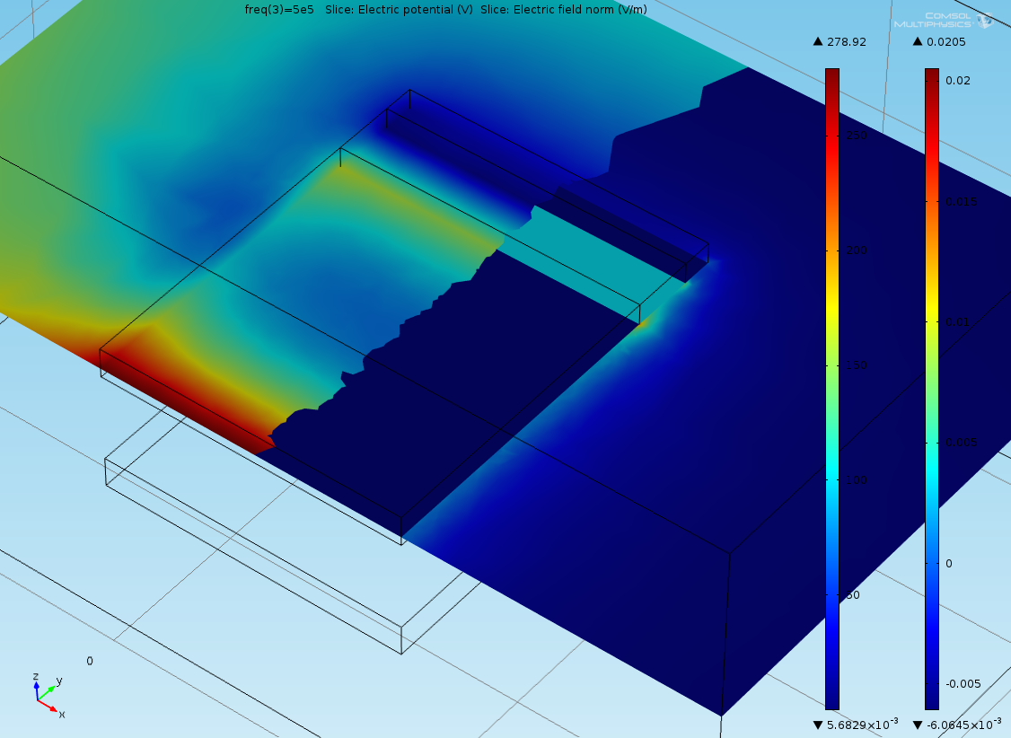

I made a simplified geometry, and the discrepancy between V and E persists!
Check it out, the attached screenshot shows a comparison of the V field and E field at 500kHz, made by applying complementary filters to the slice plots of V and E.
Also attached is the cleared model, it took 5 mins to sweep four frequencies on my workstation, but that is because I made the mesh quite fine in order to accurately resolve the skin depth (I wanted to rule this out as a possible cause). You can just change to a fine physics derived mesh and it will run much quicker, with not much different results.
Looking forward to hearing what you think :)
