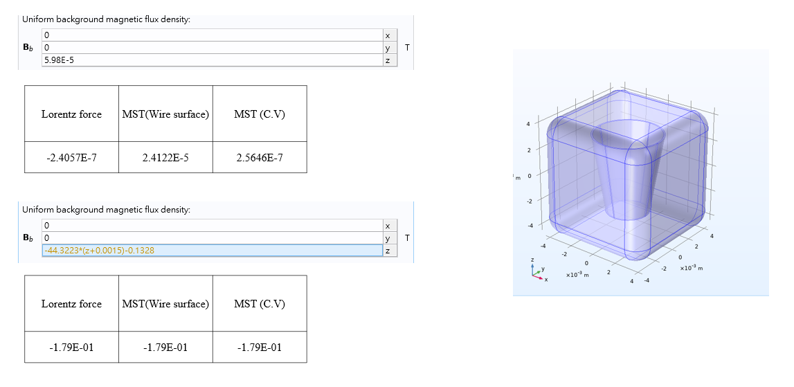

I simulated two cases:
  1. Solenoid
Under a non-uniform background magnetic field, the three methods (Lorentz force, MST over a cuboid control volume, and MST over the wire surface) produced consistent results.
However, under a uniform background magnetic field, the computed results from these three methods do not agree with each other.

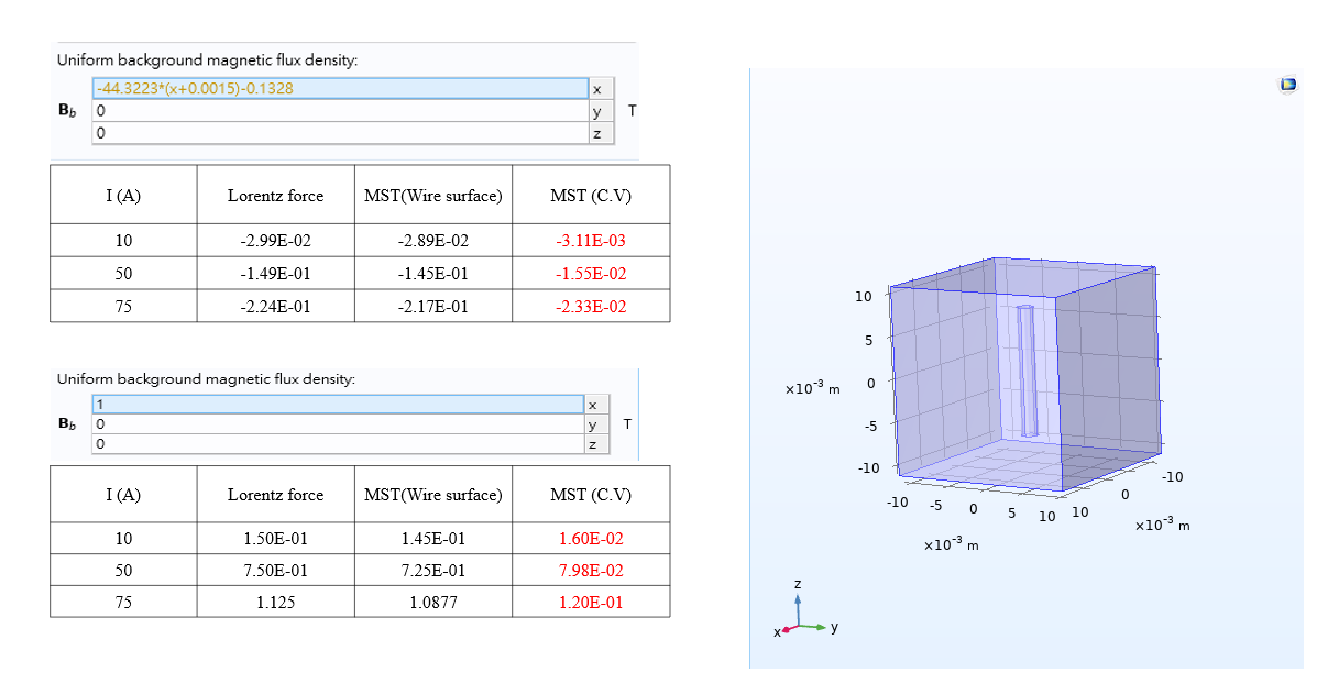

  1. Straight wire
For both non-uniform and uniform background magnetic fields, the Lorentz force method and the MST over the wire surface gave nearly identical results.
But the MST over a control volume surface did not match the other two methods.
I would like to confirm whether this discrepancy is expected (e.g., due to numerical or formulation differences) or other factors ? I have reduced the size of mesh but still does not seem to work. Thank you
