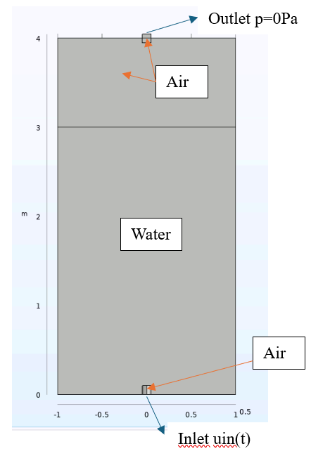

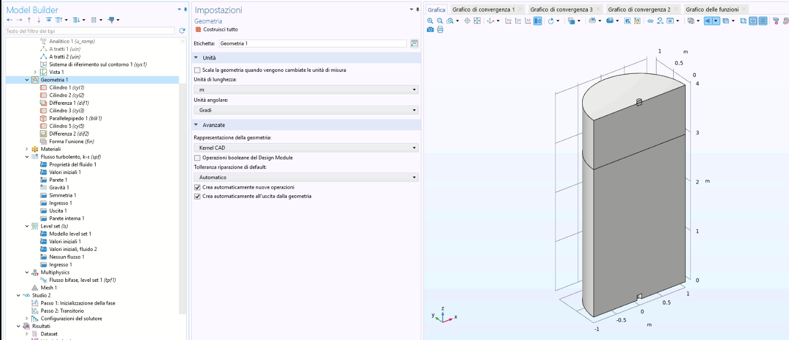

Hi, thanks for your suggestion — I’ll definitely check the possibility of a wrong negative sign. Below are some details of my setup that might help to better understand the problem, with reference to the attached schematic:
I am using a turbulent Level-Set model with k–ε, keeping the standard solver settings. The boundary conditions are as follows:
  • Top surface (outlet): pressure outlet with p = 0 Pa

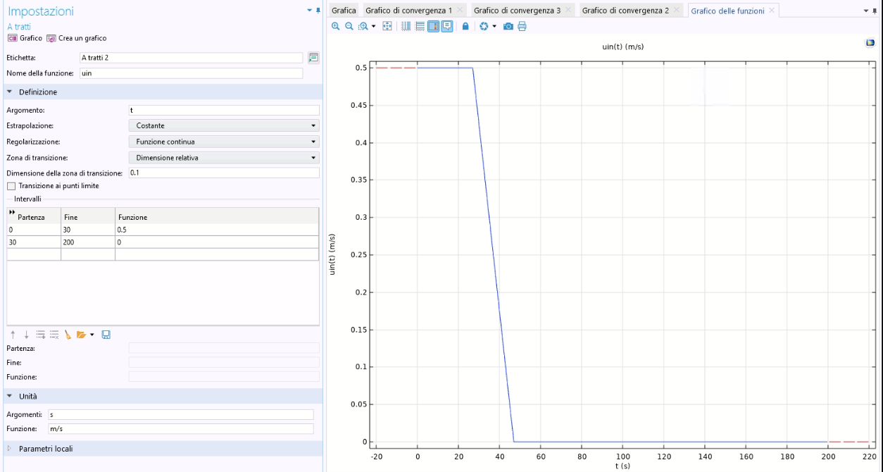

  • Bottom surface (inlet): velocity inlet defined through a piecewise time function. Specifically, for t<30s the velocity is constant and equal to 0.5 m/s, and for longer times it is set to zero
  • Lateral surface: simmetry.
The mesh is the one automatically generated by the software (default “normal” type, without special refinement). The transient simulation was run in the time range (0, 0.5, 200) with a relative tolerance of 0.3.
