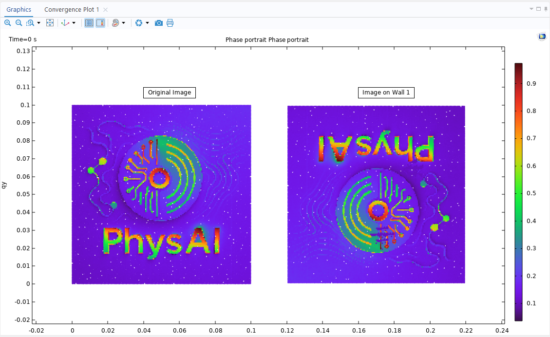

Posted: 6 months ago 11 nov. 2025, 10:57 UTC−5
Hi Daniel - thanks for the response and included model. It appears to be working now and a cursory few runs with sample values are producing results ~on the order of about what I expected. Thank you! Now I can play around and learn more about the module and physics options.
Posted: 6 months ago 12 nov. 2025, 09:35 UTC−5
After some more inspection, my only q is that even when stepping down transmission in the cross grating to an unreasonable number (~0.001) the original image of the Phys2ai logo appears the same on both sides. Shouldnt this not be the case?
