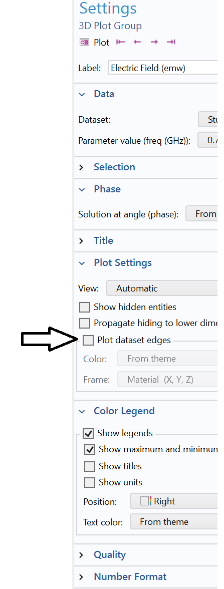

To hide edges in post-processing, consider unchecking the "Plot dataset edges" checkbox under Plot Settings in the Settings panel associated with your plot. For example, see the snapshot attached.

Thanks Robert for the reply, it works well.
