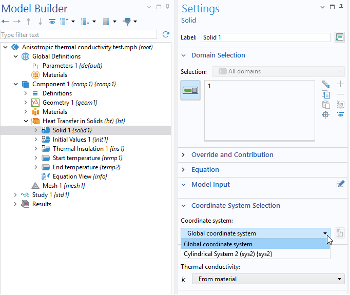

I wanted to do something similar, but for thermal conductivity instead of thermal expansion coefficient. A cylindrical coordinate system under definitions in the component has been added. However, I can't find any option to change the coordinate system in the materials model. See the attached file for a simple test file. Does the option to change the coordinate system exist, and if so, where?
Best regards, Claes

Posted: 9 months ago 17 févr. 2026, 06:01 UTC−5
I may not understand your question, but attached is a screenshot showing the coordinate systems selector that I see when opening your model.
